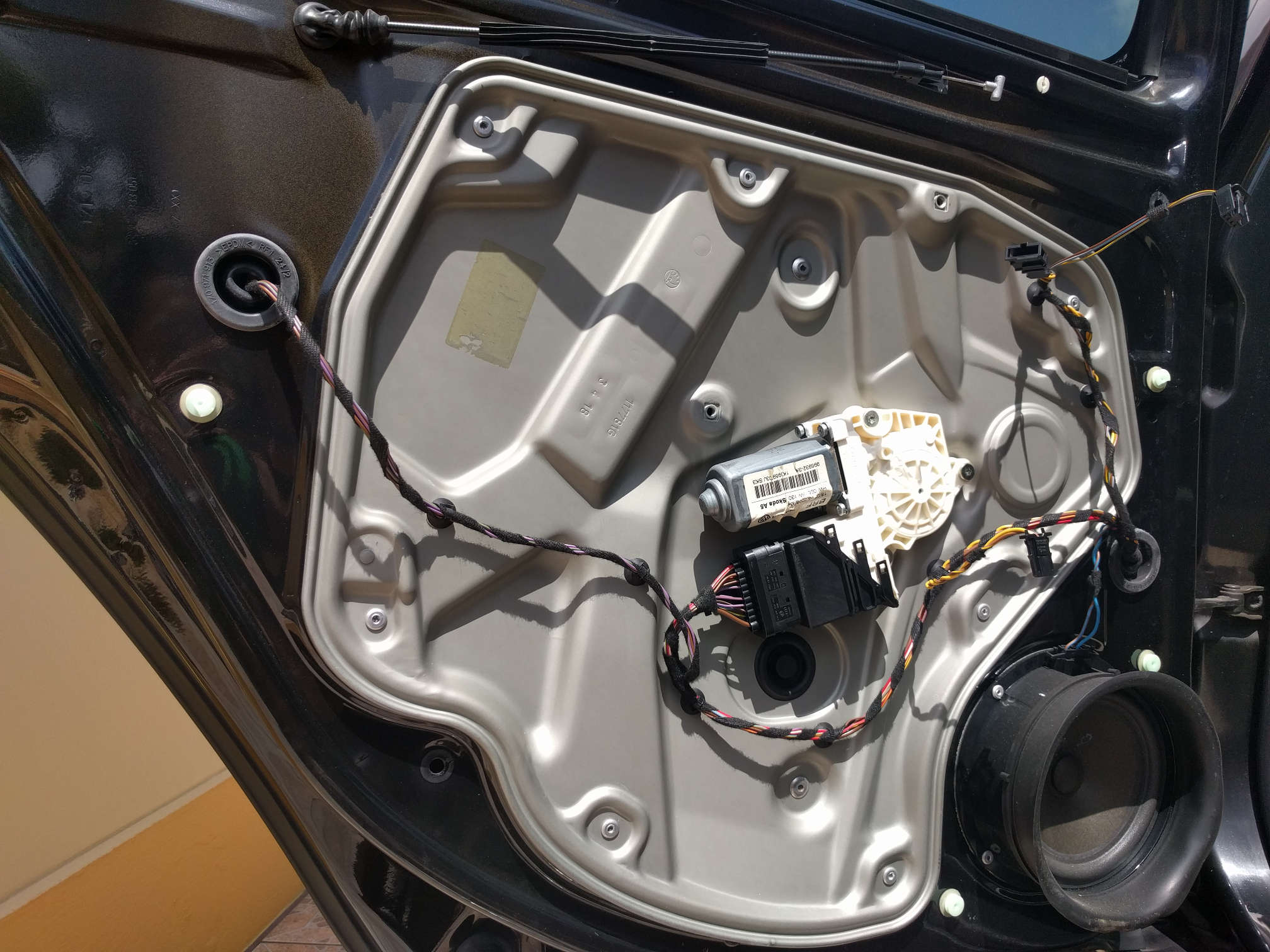

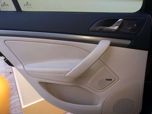

Hi guys. I'm trying to remove the interior trim of my door (See attachment). I removed the 2 screws behind the large handle/armrest and the 1 screw by small handle/speaker as per workshop instructions here.
http://workshop-manuals.com/skoda/octav ... rim_panel/
But I can't seem to remove it still. Is my door different cause of the sound system or am I just not doing it right? Thanks.
EcoTune Trinidad
Posts: 703
Joined: June 29th, 2012, 12:23 am
Re: Skoda Owners Club
Postby EcoTune Trinidad » April 21st, 2017, 8:06 pm
There are metal clips around the lower part of the door still holding in place...fit a decent size flat blade between the lower parts of the door card and prize it off the door, u will hear a loud *plax* noise but not to worry, its normal.
Oh and you need to lift the card upwards after you unclipped the card as it hangs on the window sill area
GIGAkun
Posts: 8
Joined: July 29th, 2014, 9:27 am
Postby GIGAkun » April 21st, 2017, 10:03 pm
EcoTune Trinidad wrote:There are metal clips around the lower part of the door still holding in place...fit a decent size flat blade between the lower parts of the door card and prize it off the door, u will hear a loud *plax* noise but not to worry, its normal.
Thanks I figured it had clips or something like that but I couldn't find any documentation or images specifically saying that. But I went ahead and got my plastic crowbar etc just in case. So I'll give it another go. Thanks.

Postby GIGAkun » April 23rd, 2017, 9:21 am
So unfortunately it seems my Octavia uses rivets to keep the interior thingy in place. Sooo that sucks. It was worth a shot. Thanks anyways.

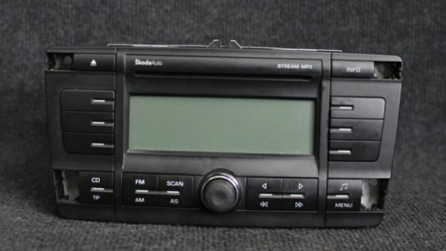

Hey guys, I'm about to purchase a used mk2 Octavia, the first model. There are not much issues, but the headunit /combination display has a shut display unit. Any one knows where I can get a replacement?
Like what's pictured.
