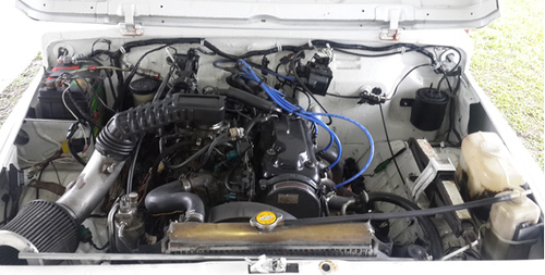

Yes it is fuel injected (most likely it wud be)
heres a picture of the engine itself to see what it looks like
aidan
Posts: 2555
Location: Saving the world.
Re: Suzuki Samurai/Sierra (Suzuki Jimny) OWNERS
Postby aidan » June 5th, 2015, 10:25 pm
That looks like an early g16A 8valve carburetted. Parts are available, but as with all suzuki parts in my experience, you have to look and will be a little costly. Those engines are very strong and with proper maintainence will last with no issues. That engine in a light jimny/samurai would be lots of fun.

:lol: :lol: :lol: , I recognize that engine bay. @aidan that's the G13BA 8-valve EPI, that was a engine/harness swap from a foreign used Jimny 1300 Sierra. Local samurais came carbureted.
