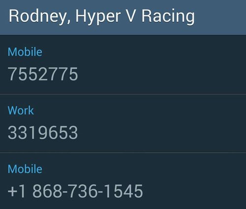

Postby *KRONIK* » April 17th, 2015, 5:30 pm
Hyper v racing:

Postby *$kїđž!™ » April 18th, 2015, 9:20 pm
Dude thanks will give him a call.....
