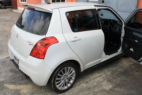

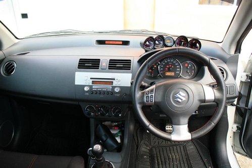

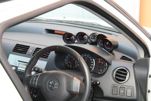

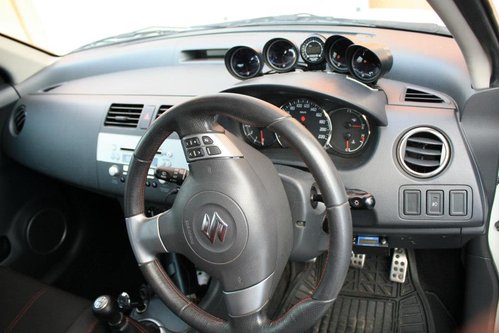

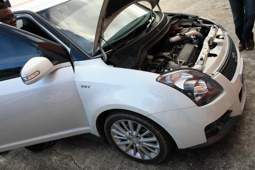

Local boosted Swift Sport
Sleeper
Engine bay
Gauges

wtf those first two pics supposed to show dey whizpig, eh? :lol: lewwe see some pics of the turbo and intercooler system nah? and what ecm is being used? Details man!!!

ok i can admit that the second pic not showing anything important, but what you not seeing inthe first one is the point, no intercooler. proper sleeper business, if it wasn't for the guages noone would have a clue till he press. As for more pics and details is not my car and i doh have permission to talk the man business, lol i only post the pics cause i found them on facebook, but i'll let the owner of the car know that ppl want details on his ride.

Nah meng... the second pic shows that the driver's door is still fully operational after installation of the turbo :lol:
