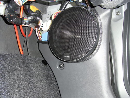

yeah i do that, btw i saw a guy do this on his jimny (not locally) for installing rear speakers. how do u find the 4'' speakers sound after the insulation? still crappy? i thought that this install look kinda cool

he put a riser and cut the outer panel to fit the grill..
