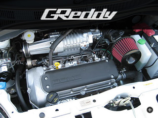

Bai......look, there are quite a few supercharger kits out there bolt on for the SSS, from R's racing, SuzukiSport, and Greddy to name the most popular.
Here's a shot of the R's Racing Rotrex:
This kit works out to about 40K TTD imported from Japan.
Here's the Greddy "roots" blower:
This kit is a little bit cheaper......haven't worked out the exact price yet.
Both kits will help the engine reach around 160 or so hp
Here's the SC150 Supercharger kit by SUZUKISPORT (yep...don't get better than being sanctioned by Suzuki themselves!)
The main challenge (as was rightly said above) is dealing with the highcompression ratio of the engine, and the lowered RON of our LOCAL gas (95 vs. the intended 98 in Japan).
There are lower compression pistons I think that are available.
Personally though, I'd have gone with a stroker or maybe just a slightly higher compression (marginally!) with better cams and tuning - the SSS just seems more right IMHO being N/A.
Now of course, if the OP decides to go the ghetto tobo/bamboo tobo-dong kit, well there's much more room for error, damaged internals, etc.
