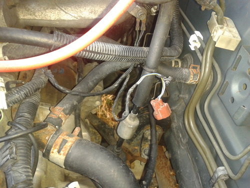

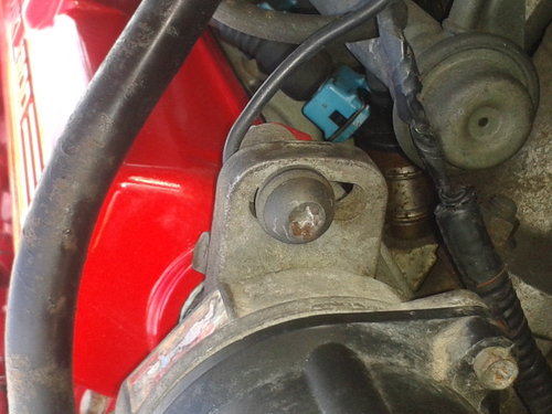

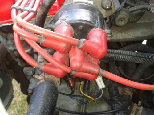

Can someone tell me what these wires/sensors are? Is this timing too far advanced? see pics.

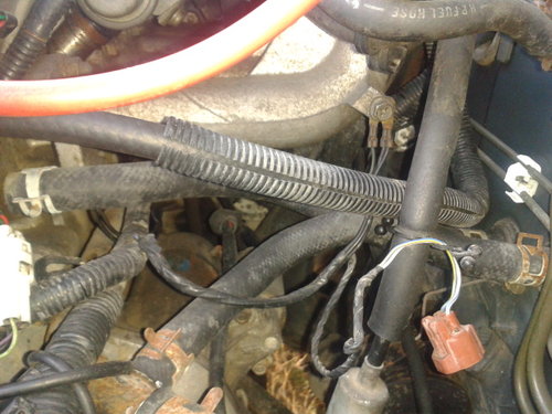

sensors? dont see an oxygen sensor.

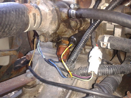

Where does this brown one go?

Postby gt4tified » June 12th, 2014, 10:40 am
Re timing and first pic, you have to look at the top of the distributor housing ....there are two arrow marks cast into either side. At stock timing, they line up perfectly. If you do advance, don't go more than a mm or two apart (in the absence of a timing light).
The brown clip on the sensor under the thermostat is the coolant temp switch for the cooling fan. The other brown clip i think is some spare as I believe my harness has that also.

Thanks for the info. One more question....Whats the sensor just above the oil filter? Oxygen sensor maybe? it doesnt appear to be in the exhaust stream. Concerning the timing advance, the arrows dont quite line up, it about a mm advance already. (toward the rear of the car im asuming) No problem with fueling as it has a new walbro high pressure fuel pump. I just cant figure out why the fuel cut comes in at 6500 rpm.

^^^ It should be the oil pressure sensor..

katastrophic is correct...its the oil pressure sensor...not connected to your ecu..entirely mechanical, but nevertheless important (in a bad way). If disconnected, your oil pressure light in the dash should illuminate. If connected, it will illuminate if your oil pressure goes below 7psi, which if it does (even on idle) spells trouble for your bearings etc.

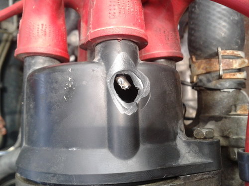

Thanks alot man!! Went for a spirited drive last night....and this is what i saw this morning :shock: What could have caused this damage?? The car still starts up without problems, I put some electrical tape around the distributor to seal the hole.... but a new distributor is now on my list of things to get....Any thoughts guys?

Postby katastrophic » July 8th, 2014, 1:21 pm
you just need to get a new cap and rotor... for the while you can seal it off with silicone or steel epoxy..

Postby katastrophic » July 8th, 2014, 3:49 pm
yup it the same rtv you would use for the seals... its a temporary fix..
but I think that steel epoxy or plastic epoxy would be a better fix.. but still a temp fix..
the lil conductor thingy that's hanging there.. Is it loose??

Postby SuzukiMan365 » July 8th, 2014, 3:57 pm
i dont know i didnt touch it. just wrapped it with the electrical tape

Postby SuzukiMan365 » July 30th, 2014, 4:53 pm
Well i patched the hole....not pretty but it works. Mechanic who changed seals used honda parts. Took it for a drive today and reved to near 7000rpm. Still be needing replacement though. Here are some pics.

cool... that should hold out for the while...
I've heard that a distributor cap from a mazda 323 (not sure which model or year) works as a replacement.. Maybe you can look into that...
