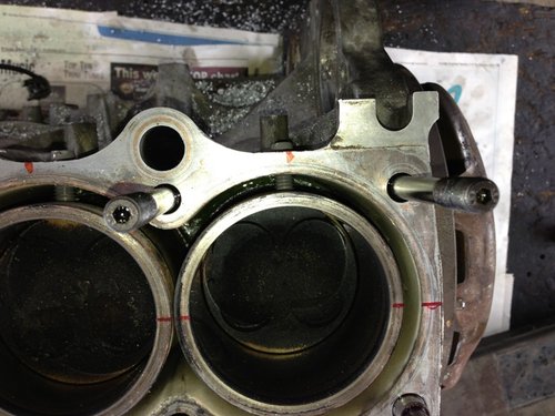

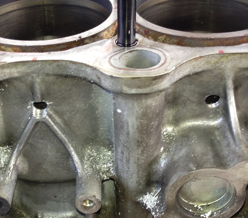

So I decided to prep my car for the 2013 season and I started by addressing one weak point with my car that I've discovered so far.
Due to the high rpm I run and the slightly thinner cylinder liners due to my over sized pistons I've found head gasket sealing to be an issue. So my plan was to re-enforce the sleeves by an old school technique called posting or pinning the block.
Here are some pics of the process.

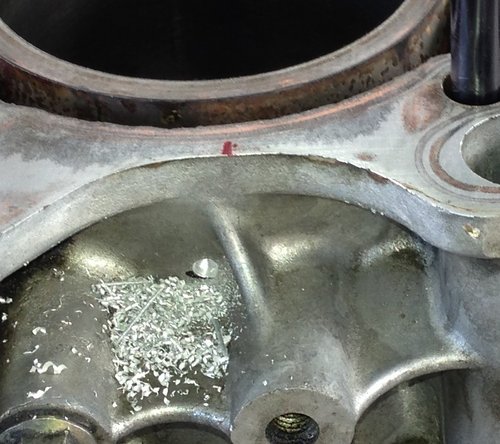

First find the approximate center line of each cylinder..

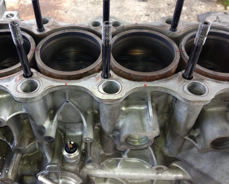

Then we decided how far down the block we would put the posts, and start the drilling!
I should mention that the post were cut from 3/8 threaded aluminium rod. Using the same material as the block would ensure expansions rates are uniform.

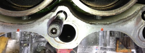

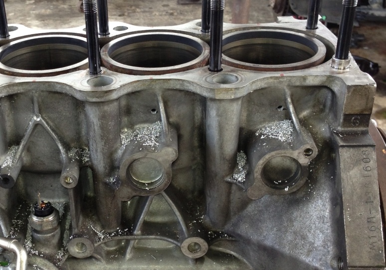

Now the holes have to be tapped with the appropriate cutter.

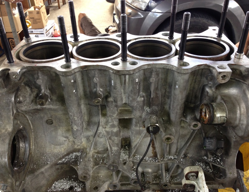

Postby rado » February 9th, 2013, 5:08 pm

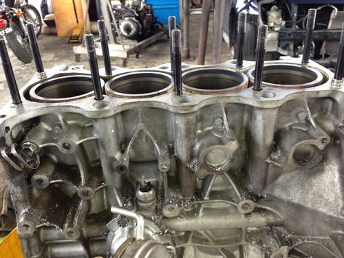

Finally just insert the pins and hand tighten snug with the sleeves. I used marine grade JB weld epoxy on the threads and over the installed plugs to seal it up. The JB weld is rated to 500 deg F which is way higher than the operating temps of any engine.
The net result is considerably stronger sleeves with no compromise to cooling efficiency. In conjunction with a correctly sized head gasket it marks the end of high RPM head sealing issues.
Here are a few pics of the final product.
whizpig
Posts: 316
Joined: February 4th, 2010, 6:05 am
Location: Arouca
Re: Autocross prep 2013!
Postby whizpig » February 10th, 2013, 4:44 pm
So yuh back in the carpark this year?
but i doh understand how reinforcing the cylinders improves the head sealing, of course this stems from me not fully understanding why high rpm results in poor or insufficient head sealing, is it a vibration issue perhaps?
rado
Posts: 695
Joined: July 7th, 2004, 8:53 am
Location: Arouca
Postby rado » February 10th, 2013, 6:04 pm
yup all tests are positive.
Since our engines have floating cylinder liners, there can be movement though small. Hi RPM just amplifies the situation.
I should also point out that my head gasket was the exact size of the cylinder bore. This is not the ideal case. There should be some relief between the HG and the chamber. For example the stock cylinder is 78mm and the stock HG is 79mm. This is a key factor also.

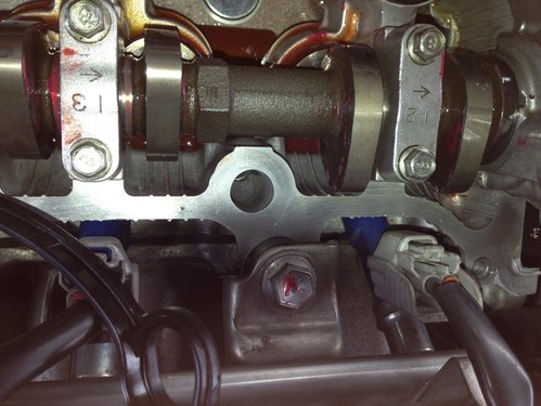

So since I pulled the engine for the block enforcement I decided that I would change out the cams.
Check out the lift on these bad boys :shock:

It was a known possibility although I was hoping to be able to tune it in. The LSA ( lobe separation angle) of the cams is smaller than stock and does not promote strong vacuum and good idle manners.

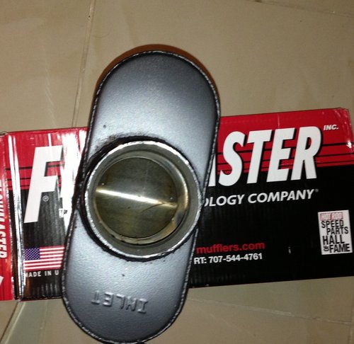

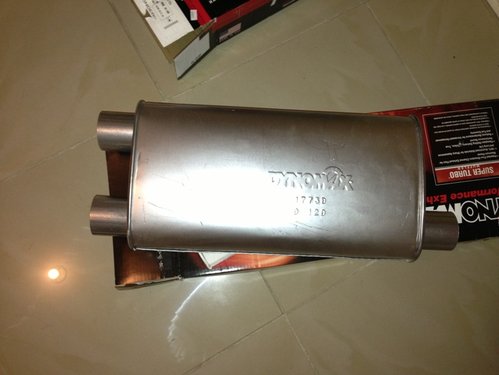

Anyway I still have a couple basic updates to complete to the exhaust system geared towards fine tuning the torque curve.
Gonna put these on soon.
