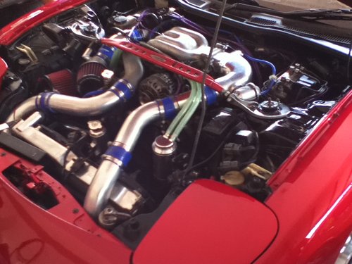

This is a nice example of a good street daily driven FD we did.
- Knight Sports ECU
- Front mount Intercooler bolt on kit
- Apexi Twin Filters
- Aluminium AST
- Aluminium Koyo Rad
- Greddy downpipe and exhaust
- Air pump removal pulley kit.
- HKS grounding kit (this actually made a world of difference!!)
and thats it! well plus brake and suspension mods simple and works great!

Did not dyno this car but another fd we know with almost the same mods got 330 whp
