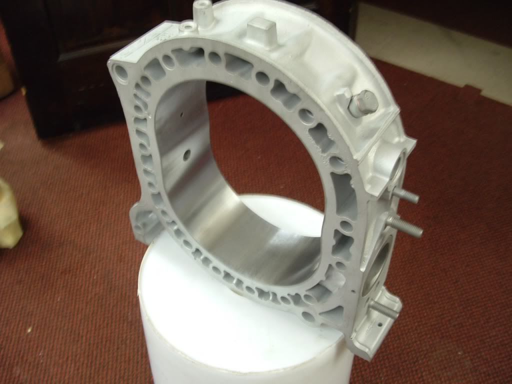

I have been working with Jon from Goopy Performance on and off for many years. Many times we have different views, but when he comes up with something that works, well I have no choice but to post some of my results and experiences. Jon has perfected a way of resurfacing used rotor housings. I mean this is pretty impressive considering most of us throw away rotor housings that he brings back to life. I will post pics of before and after.
Back in late 2007 Jon came over to me and asked me to try some crappy rotor housings he had resurfaced. I looked at them and said "Jon this will not work" Jon said: "Ito just try them". To give you guys an idea, those housings were grooved pretty bad by the outer edges of the housing and the trailing plug area were full of vertical grooves .(a common problem) and pretty much garbage. I Put 1 engine together using his used resurfaced housings with New oem 2mm apex seals. After 200 miles of driving I gave the engine a compression test @ 195 degrees of coolant temp. The engine gave me 125-128 psi with a conventional compression tester.
Since then I have put a few engines together with Jon's resurfacing. The better the housings are to start with, the better the resutls. The FIRST THING I NOTICE IS THE REALLY GOOD FLAT SURFACE after the resurface. On my last engine I did a compression test and pulled 131-132psi using his 2mm apex seals. I was stunned to say the least. I'm here applauding Jon from Goopy performance not for perfecting this resurfacing on other wise rotor housings we would have thrown in the garbage, but for his continued hard work to improve all kinds of minor and great details this engine has to offer.
for info. you could pm me.. I'm a skeptic that turned into a believer. congrats Jon.
pics of before.
after.

direct information from Goopy Performance.
In today's economy everyone is looking for cost effective solutions and the best way to get maximum performance for their dollar. That was Goopy Performance's thinking and objective behind our ROTOR HOUSING REFURBISHING service.
When any of us consider rebuilding a rotary engine, the condition of the housings is a key factor. Up until now the options have been either 1.) use your housings as is or 2.) buy new housings at the cost of approximately $1,300 per pair or more. If porting had already been done on these housings, the real cost of replacement could include an additional $200 to $400.
Goopy Performance's process provides a solution at approximately 10% of the cost of replacement while providing not a 100% new surface for your seals to break into but a "like new" surface in the very high 90 percentile (95-99%) in most cases.
Here is an attempt to answer most of your questions from recent posts ...
1. We are NOT resurfacing or adding new material to the housings. We are refurbishing or refreshing the existing hard chrome surface.
2. NO we do not have data or photos showing results after 20,000 miles. However, we have had very high HP racers running our refurbished housings with our Goopy Performance Apex Seals for a full race season (40-50+ passes) while maintaining very high compression and no damage of any kind.
3. PRICING is $125 US per pair of housings with you paying for the shipping to and from Goopy Performance. This includes media blasting of the housings to achieve the "like new" appearance as seen in Judge Ito's photos. Please do not send dirty, greasy housings or there will be an additional $25 “Cleaning Fee”.
4. Our refurbishing process greatly improves all of the conditions mentioned in various different posts ... scratches, scoring, gauling and flaking edges. Our process provides a relatively flat, uniform, matte housing surface for your new seals to break-in to. The true measure of the effectiveness of the process is the compression numbers that are achieved when your engine is rebuilt, not just how the housings look. Our experience with our refurbishing along with using our Goopy Performance Apex Seals is that we have consistently produced compression readings at or above factory stock specifications. Also refer to Judge Ito’s experience after 3 years of having compression numbers of 125-128 psi.
5. The SIDE PIECE on the Goopy Performance Apex Seals does not come to such a sharp point at the housing surface like if does on many other apex seal designs. We believe this design improvement yields less wear and deterioration at the housing edges that cause potential compression leakage.
6. In most cases the amount of material removed to achieve these “like new” results is relatively insignificant. In our experience, utilizing our Goopy Performance Apex Seals which are manufactured at the same height as OEM seals, we have not experienced any issues due to the removal of this minimal amount of material.
7. If you are unsure if your housings are candidates for our refurbishing process please send photos and description to info@goopyperformance.com before expending your time and resources on packing and shipping.
However, if we receive housings that we consider to be beyond repair with our process, we will notify you before any work is done.
8. We provide our housing refurbishing service on all models of rotor housings.
Please email to info@goopyperformance.com if we have not addressed all of your earlier questions or new ones have come up in the meantime.
