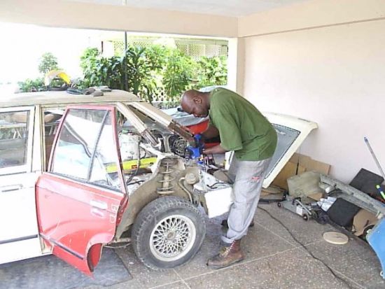

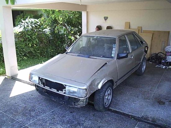

this laser is special to our heart, its our first car, my mom bought it from the firm in 1983, it carried us to school and back everyday. It had 13 E5 engines and one transmission. After my mom got another car my dad took it, and anything he gets he runs to the ground. It get fender benders, rusted though in a real mess was in 3 different colours although the colour supposed to be gold. He started transporting feed bags and then one day we heard crack and the whole rear shock tower broke.
thats my dad running the car to the ground LOL :D

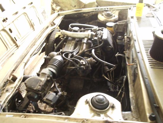

well remember Shiva from the laser sedan build?? Well shiva has also a part to play in this story. Now Shiva was a rally navigator for another car, a BF 323 GTX which the driver was Dave. Somehow the car ended by shiva and was for sale. Shiva called us to come check it out, but as usual was was brokes.... but was was thinking would not it be great to take this car and convert our rotton down laser hatch 4wd turbo?? hmm
Well a few months passed and on the day of d trini hurricane, the same car came by us with a different driver!!! another friend came to show us d car d price drop now though.... like this car only following us!! so we borrowed some funds from d family and bought the car. i am sorry i dont have pics of the whole car... this was the time i did not have a cam.
So we had a 4WD BF GTX, we had a laser but had NO IDEA what d hell to do to convert it!

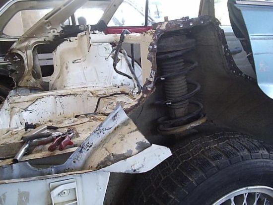

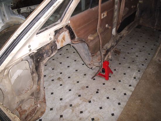

We started looking for body shops to take on the job, everybody literally run, said this CANNOT be done. One actually said it could BUT the laser will have to become a 2 door. That was not the concept we was going after it supposed to look like a normal 4 door laser sedan. So we got word of a man named Cokesin(doh ask) that gave us some advice on what to do and we endup doing it ourselves.

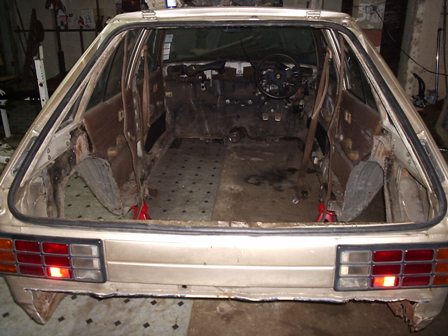

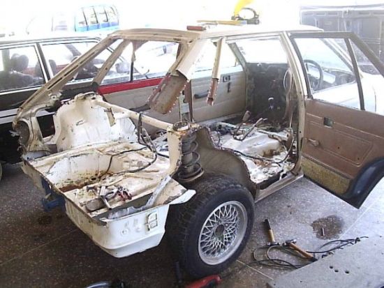

so we endup cutting the 323 GTX ( i am so sorry i dont have any pics of the actual car!!!) into a floor up to the firewall with the rear axle intact.

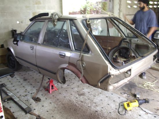

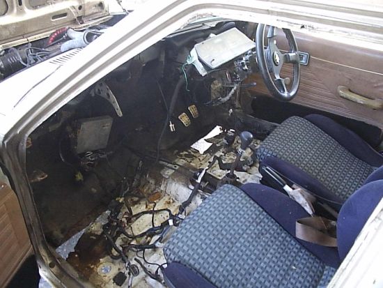

Then we removed the flooring of the old laser. You can see in the pics how rusted the metal in the laser was.
see man ent even getting time to get haircut and shave LOL :D frustration!!!
Now the whole point of all this is to get a 4WD flooring into the laser, so no driveshaft issues, rear 4wd axle, handbrake, cable shifter and the 4wd gastank goes back up as original also GTX seats and every flooring shape for 4wd remains the same. :) :)

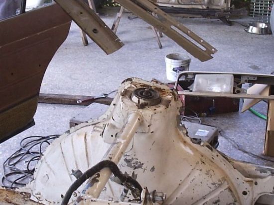

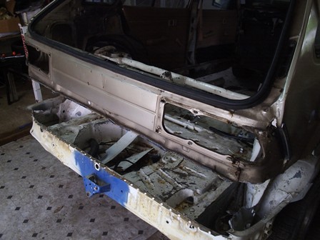

So the two pieces are now prepped to come together so a BF GTX hatch and laser hatch basically has the same dimensions so its just to sandwich the two peices and firstly screw it in with self thread roofing screws (we was trying a thing).
So the car is now as one with all mehcanical in. we actually drove it holding with screws just to make sure it was working properly. make a block around the neighbour hood LOL :D :D
notice the space at the base of the firewall. This needed to be welded in place.
Accordiing the time line, this took a year i think the whole of 2006. We started Dec 2005.

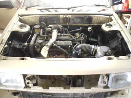

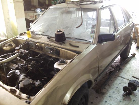

no you all mustbe wondering about the engine and its 4wd gearbox how it fit in the engine bay. We used all the GTX mountings to the laser body and using the GTX crossmember. The transfercase was slightly touching the left apron so we just cut a little about 1/2 inch.
Its now the end of 2006. The car is driving on screws and ready to go to "a" body shop.
notice the back doors cannot close due to the wider GTX inner fenders.
So we carried it by Cokesin to work on it. It stayed there a year with no work done. He had no idea where to start. We actually forgot we had a laserhatch!!! :shock: :shock: so at the beginning of 2007 we carried by another body shop where the guy stole our brand new door rubbers and still did not know what to do with the car!!! DRAMAS!!!
In March 2007, we got word of a guy named Perry( the lineup king) did this sort of work actually doing the joining of cars, 4wd work. He is also a serious evo fan LOL.We got good foreign used doors, 2 rear quarter panels and other various body parts. he did all the welding, lining up making sure we did not look like those bendup chassis trucks and 120Y on d highway. :D

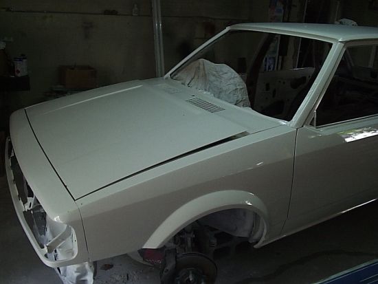

ok well i have kept allyuh in suspense for too long so on with the story! So mr. Perry finished up his welding in about April BUT perry does not paint, so in comes talls to finish up the car. Talls specialise in older cars and did the painting by us. Well after the fiasco with the 2 previous bodymen we did not really want to go by a bodyshop anymore. Same situation with mechanics but thats a another story all together.
Here is some pics of the car being painted, the car went down to shining metal and then straightened, primed and painted in Chaste White.
Notice the doors lineup now...

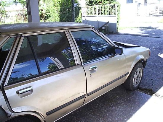

so basically at the end of Aug 2007 the car was finished ready to drive. We starting the car, making sure everything wa working properly, realising a few problems. One was the 4wd 10.2 brakes had a different streering angle to the FWD so the car was unstable on the road. Also the rear left caliper was gone! smoking like crazy!! so for the while until we found some FWD big brakes we got some 9.6" to drive tha car. These actually causes a little more problems than we expected.
So one early sat morn a pardner wanted to see how the car running (bad move) so took the car around the block got to about 90km/h at the end of the hill mash for brakes we gets NOTHING!!!! so to avoid hitting a wall, hit a colvert and into sum bush. :( :( Looks like the front brakes was still rusty shoudda skim the rotors, and the rear left stop working so only the rear right doing a lil thing. the damage was not so bad actually just bent bumper, the left frame rail get it but the door could still close.
so bend back the bumper and fix him back, still did not get around to fix the frame rail.
Well next step was to run the exhaust, so we did a 2 1/2 exhuast by Specialist Muffler 2001 nice job too i will take a pic when i get time with a cheap barrel at the back.
