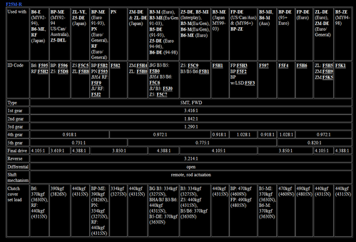

scypher wrote:im nt exactly sure if im misunderstanding you but the z5 box bolted up on my local BA which waz a 1600cc eng not a ZL engine
Z5 gearbox is a f series gearbox, F25m-r is the model to be exact.
The gearbox from the this table below are all interchangeable.
The zlde,z5,b6, all have the same block, and use the same box type
http://www.protegefaq.net/transmission.html#F25M-R
