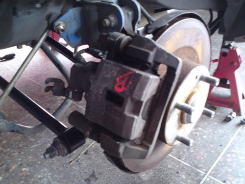

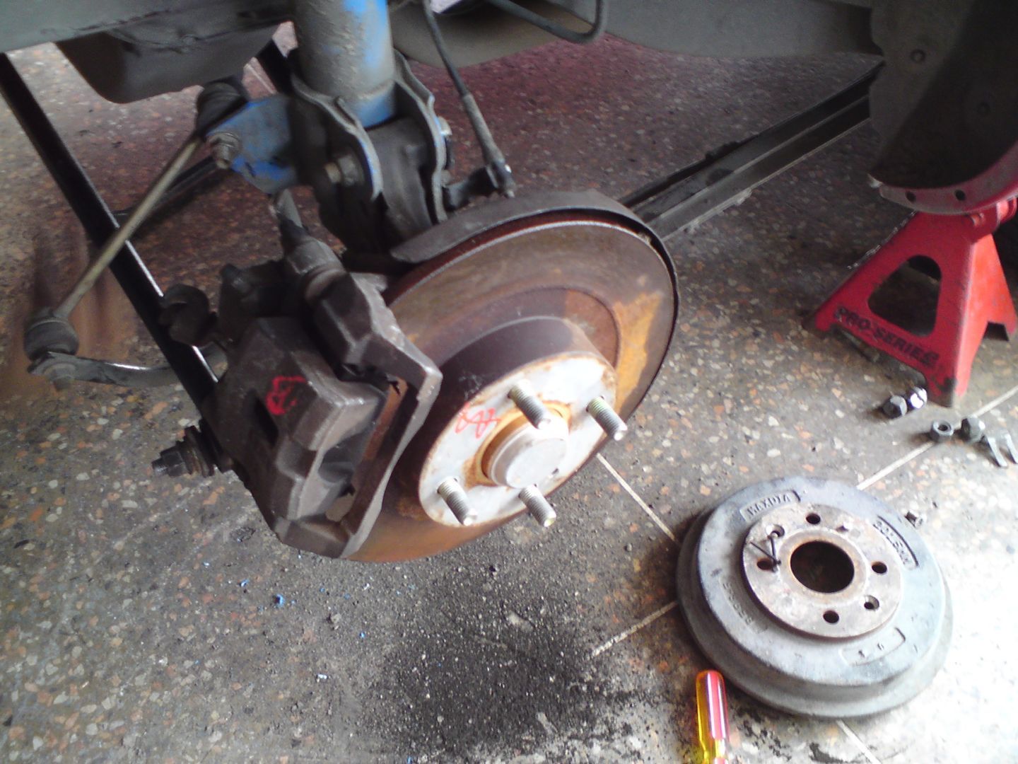

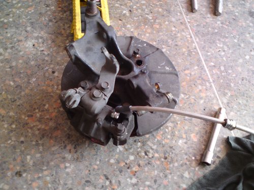

ok time to do some brake upgrades. The brake lines have to be changed to a disc brake type so we brought in a set of Corksport Steel Braided lines for the BJ Familia/Protege at a cost $1200.00 for the set.
So we removed the ugly drum brakes by taking out the 2 17mm bolt and nuts off the shock, the 17mm off the trailing arms and rear sub-frame arms removed. Now the 2 subframe arms are different to the one of the drums, so they either have to be shortened or replaced by ones from a disc brake model.
We then installed the rear brake lines on the discbrakes and just put the ABS sensor to one side, careful not to pull on the wire. (had some issues with ABS codes when we put up the shocks :oops: ) . The new arms were installed with minor troubles then replaced all bolts.

Postby nareshseep » July 19th, 2010, 1:38 pm
So Maztune its not a direct bolt up?
MAZTUNE
Posts: 1379
Joined: October 17th, 2006, 8:04 pm
Location: San Fernando Trinidad
Re: MAZTUNE mom's 2001 BJ Familia RS build
Postby MAZTUNE » July 21st, 2010, 2:27 pm
nareshseep wrote:So Maztune its not a direct bolt up?
from drum to disc...no. if you are taking it off a complete RSS rear subframe it will be a direct boltup.

rear disc not so hard to get you will just have to convert to five hole .........
four hole rear disc hard to get because afaik tht was a JDM only package the USA only got rear disc in five hole ..........i think

red bwoy wrote:rear disc not so hard to get you will just have to convert to five hole .........
yup sport20 5 hole setups easier to come by.

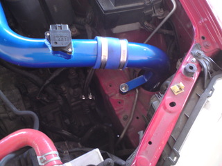

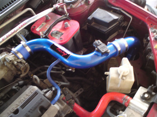

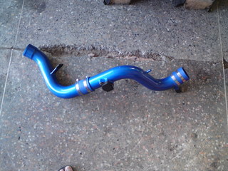

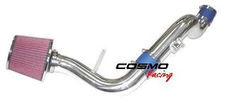

ok so decided to put in the Cosmo Racing Cold Air intake in my mom's car. Official thing lol. So removed my makeup cold air with a 3" filter to 2.5" reducer. This system is a complete 2.5" mandrilled alumium piping with built in watertrap right before the MAF. not bad for $1800.00!! So the kit is a direct bolt in with a simple 10mm mount/bracket. it;s mounted on rubber so any engine flex it would absorb it pretty well.
Now the kit comes with a non-reusable filter with could be replaced with a K&N when it's done.

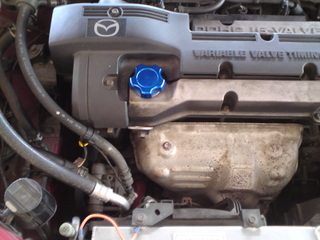

As an added touch to complement the christmas tree engine bay, I put on an OBX Oil fillter Cap ($160.00 and in stock LOL) :D :D
OK RESULTS - Maybe because of the 2.5" piping response is quicker, a little more mid end torque, but again I getting to hate this tranny. Don't worry one day. my pretty. one day. IT SHALL BE MINE heheheaaaeeeoooaaa :twisted: :twisted: :twisted: Oh and that day a 4.4 ZL-VE box awaits...

Postby Wildcard26 » December 20th, 2010, 4:36 pm
Maz I feel I will have to check you for that OBX oil cover cause mine leaking and I find it hard to get the Corksport one. If you had a Red in it that would have been cool, Let me know.
The filter set up looking good. I find you gone Harry Potter on us dey boy....Good work though.

Wildcard26 wrote:Maz I feel I will have to check you for that OBX oil cover cause mine leaking and I find it hard to get the Corksport one. If you had a Red in it that would have been cool, Let me know.
you mean lord of the rings lol no boy no red only polish and blue

Postby MAZTUNE » January 4th, 2011, 12:40 pm
well first time I drove the car in the night after I put in the intake. Waw, it feeling so responsive and a nice increase in power, RPM, building smooth and it does not have to struggle to reach high speeds. Really a good performance upgrade...wish I had that box now...:-(
