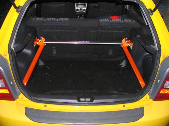

Well after after adding that front strut bar, my interest has peaked in handling upgrades, so I looking to get something for the back, options are rear sway bar or rear strut bar or trunk brace, my thinking is that the rear sway bar > rear strut bar > trunk brace. Disadvantges is that the rear strut bar and trunk brace, takes up valuable space in the back.

nareshseep wrote:Well after after adding that front strut bar, my interest has peaked in handling upgrades, so I looking to get something for the back, options are rear sway bar or rear strut bar or trunk brace, my thinking is that the rear sway bar > rear strut bar > trunk brace. Disadvantges is that the rear strut bar and trunk brace, takes up valuable space in the back.
My other 2c....most folks rush to do strut bars etc etc on their cars, when they can't really maxmise the potential of the parts they're buying.
Also, most people assuming "corner lean" = "corner grip" (it isn't).
If you're really interested in going a little more precisely around corners, and minimizing understeer.....I'd have done this (applies to any car):
1) Get rid of the crap tyres you MAY be driving on. If you aren't....great! Get some good tyres e.g. BF Goodrich G-Force Sports, Proxes T1R's, Dunlop SP SPortMAxx's, Kumho Ecsta Supra, Potenza RE040/RE050/S-02 (pay attention to the bolded model designations).
2) Look at adjusting camber settings around the car if possible. Increasing front negative camber while decreasing rear neg. camber (if it can be done at the rear), will lead to less understeer, and a switch to a slightly more progressive understeer - to - neutral feel. If done right, you may be able to experience just a hint of oversteer on throttle lift off, or if following a trailbraking line - which will lead to better turn into your corner apex.......
Having crappy suspension settings, and tyres, only devalue strut bars and the like (and I've never used these on any of my cars yet....except the 8....which has one already :lol: )

Points are noted, good tyres increase braking and cornering ability. A rear strut is necessasy for the 323 hatchback as it has no rear support as the sedan.
however, on the topic of cambering wouldnt adjusting camber increase wear on tyre life?

^Yes it increases wear on tyres. Stock camber for most cars is at least somewhat negative at all our points. unfortunately, many local "shops" put the tyres vertical (as in minimal camber) in order to maximise tyre life. That adjustment reduces "handling".
Stock camber settings are normally setup with more negative camber at the rear than the front, which leads to predictable understeer - which is easier for the typical ham-fisted driver to handle. Oversteer on an everyday car is not considered industry practice.
The key to tyre wear comes down to regular rotations..and that helps esp at more aggressive camber setups......and if I know I'm going to run a softer compound, I try to avoid unidirectional tyres as far as possible, as that makes diagonal rotations harder (you'd have to remove and remount tyres in that case).
But if someone is worried about wear on tyres (and saving money), then clearly, they aren't prepared to buy anything other than a hard compound tyre, which probably means they aren't going to explore handling potential more than putting on a strut bar and feeling like Takumi's long lost brother.
I'm not a believer in excessive chassis/frame stiffening devices for a daily driver on LOCAL roads, as it leads to increased stress at suspension mounting points, since the body doesn't flex as much.
Keep in mind the body of your car is technically a part of your suspension - it flexes and twists as each wheel moves over bumps independently. In fact, for the WRX, I was considering a Cusco Hbrace and floor pan braces, but was advised against it by Jaime "Subiegal" (rally driver and shop owner)....since she encouraged/recommended more suspension and body compliance over choppy roads, with more attention being paid to sways, tyres, and spring rates.

True boi Wildcard26, man having me seriously questioning what to do with the suspension setup. I was all go on front strut and rear sway bar, now I have to reconsider...lol....a lot of info gain here for true from Alpha_2nr!
It is one complicated procedure balancing handling and comfort. I have a strut bar on the zmde sedan (stock with soft generic strut bar) and hatchback (dropped with stiff strut bar) what I realise is that the sedan ride is much more comfortable than the hatch and gain much more benefit from the addition of the bar which was the reason I got one for the hatch. May opt to go to mazdaspeed springs (0.75 drop as opposed to the 2" drop from the teins (currently) and tokico shocks.

also, installing a strut tower bar is not so simple as bolting it up, ur supposed to jack the front of the car up to allow the strut bar to pull the tops of the shock mounts slightly creating a small amount of negative camber...tighten, torque nuts jack down...

naresheep, (front strut bar ^ rear sway bar)=oversteer=((fun) v (death))
lotsa fun and once u get accustomed to it ur not gonna want anything else.

@ghostbusters the strut is a fixed joint type, I doubt if I jack up the car it will get a negative camber.
With the strut bar it take less effort to turn corner, and the car is a lot more stable at high speed. Cant wait to get that rear sway bar!
That spring and shock combo sounds pretty dope...I've always been a proponent of those versus all-out coilovers (not sleeves that is eh!) for trini roads. Tokico Illuminas I trust?
Keep in mind another misconception with springs (I've experiemented with this on other cars...).....folks assume dropping the car=better handling because of a lower centre of gravity. While you will have a lower centre of gravity, if the springs and shocks aren't matched in terms of rates, then you technically lose "bump traction" (or simply, wheel contact with the road).
An easy way to tell is if you get a somehwat bouncy feel when going over choppy road with your car. Chances are (assuming your shocks aren't dead!) is that the damping rates of your shocks are too soft for the sprnig rates.
Also, keep in mind lowering TOO much is also detrimental, as it affects the very suspension geometry of the car, since the available portion of the "camber curve" on which the wheel moves when going into corners is now less.
'Camber curve' - remember as your shocks/springs are compressed as your car rolls to one side, the camber of that wheel changes a little also. Lowering too much means a loss of suspension travel, adn loss of the camber "flexibility".
Which is probably the reasons why Mazdaspeed only lowers by 0.75", as they'bve probably deemed that the best compromise between stance, spring rates, and good traction.
Not to bash S-Tech Teins...but remember Tein said it themselves - those are "dress up springs" (as in appearance).
You're spot on with that. A strut bar helps steering "feel" and response. Your car is a BJ 323? Do those use rear sways? Careful with selecting sizes!
