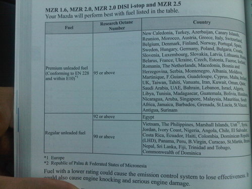

Hmm.. This is from my Mazda 3 2012 Manual. I guess i can use super. I hope this was even more insightful. Oh Btw my car is the mzr 1.6, and Ghostbusters what do you make of this?

So if you in Jamaica, Barbados, Grenada, St. Lucia etc.. it's 95 but in T&T it's 90? Our fuel soo good!?

Pay more use premium. Super costs less but risky.

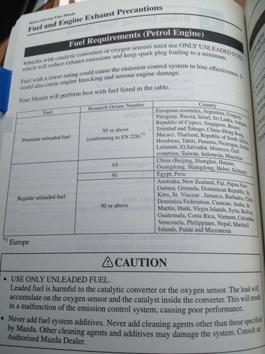

This is what my manual says
My car is a 2005 model, so either the quality of our gas improve from 2005 to 2012, or Mazda did something to the engine to better handle lower octane (same 1.6 MZR).
