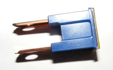

Afternoon All,
Car Specs:
Mazda 323 BJ, ZM engine
Problem:
So i removed the battery but re-installed it incorrectly, i connected the +ve lead to the -ve terminal.
Now my car wont start.
Troubleshooting:
I checked all the fuses in the fuse panel inside the car (under the bonnet lever).
The engine fuse was not blown.
I then checked the fuses in the engine bay but you cannot tell if these are blown cause they are not transparent like the other fuses.
Any ideas on how to check these?
Or should i just take out the engine fuse and replace it?
Any help would be appreciated.
Re: Mazda 323 Issue Thread: Post your problem.
Postby cinco » October 5th, 2014, 8:52 pm
change the engine fuse and see if it helps
i hope you havent blown the ecu
does it tumble at all?
nerad17
Posts: 15
Joined: August 28th, 2009, 10:44 am
Location: San Fernando
Postby nerad17 » October 9th, 2014, 9:55 am
Hey..so i checked all the fuses in the engine bay except the one 100 Amp engine fuse.
i missed it completely because the labeling was confusing, and also because the head was broken off and an electrician jumpered it. It was not one of your conventional fuses - like the ones you push in and pull out, it actually had two bolts holding down this fuse. i had to remove the entire fuse box just to take it out (see pic). Thanks for the advice tho.
100 A engine fuse.jpg (18.07 KiB) Viewed 19903 times
