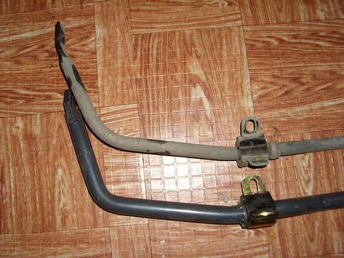

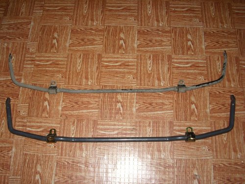

Well guys, I could'nt wait to put on the sway bar, so it went on this evening!
Anyone can do this,its very simple, note an allen key is very necessary if using back your old linkages. Started 5pm finished 8pm. Those led headlights are very useful in situations like these, All you need to remove is 2 17 bolt on linkages and 4 14 bolt that hold the sway to the sub frame with the bushings. And thats it. Carried it for a test run and I must say its a bit scary, will have to take it easy on rainy days, cause body roll has been reduced dramatically, and because of that you may want to push the car a lot more on corners. The hatch now corners like a sedan! Woi. Next upgrade better tyres.
Progress 22mm rear sway vs stock (17mm?) rear sway on the P5,

told u it a bit scary, trust me, u cornering much better than a sedan now, consider kumho ecsta spt if you can find them(laughlin says they dont sell them anymore) and if u have negative camber check out the nitto neo gen, they specifically made for cars with negative camber they dont cut away on the inside(also AA traction).good stuff man. you feel the weight difference i was telling you about?

@Ghostbusters the stock feels like crap , weight wise compared to the progress, will look out for the kumho ecsta spt.
