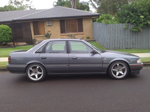

Postby sinister626 » April 18th, 2011, 7:03 am
Hmm not sure if the rear disc brakes for Mx ever came 4 stud padna, 5 stud yea. Most likely you will have to get a complete 5 hole setup from the GT model. The five stud setup carries an 11" front rotor compared to the crappy 9 3/4 4 stud we got locally.
Is your F2 Turbo? Even if its not you should still upgrade your 4 stud brakes. Most 323 shud work, with some modification. Mazda 323F Lantis rear disc may also work in the rear of your mx. (I see man puttin corolla disc already so why not 323.)
When I get my mx mine was'nt stoppin at all even when ah drivin slow. I still have in d 1.8 sohc muchless fuh ah F2. So far I put in the brake booster from the Sport 2.0 323 and temporarily swap the mx front spindles for BJ and now ah stoppin like WOW!
I do have the 5 stud GT brakes ress dong doh plannin to put in 1 day (unless ah change meh mind an decide to sell)
An padna nex time doh throw away d F8dohc nah, dem engine hard to find now. Put ah post in forum fuh sale or sumtin ok...
This pic below is a car in Australia. These guys dont fool around with their Gd/Mx. Notice the Front and rear disc, also the front is converted to double piston...

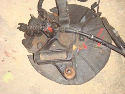

mad-za
Posts: 48
Joined: January 4th, 2010, 9:52 am
Location: GROUNDED!
Re: 626 discussion
Postby mad-za » April 22nd, 2011, 11:12 pm
sinister...well i seein lots of glx models with d rear disc set up.....but hard to get again..:( ...but tell me something na....how much modification will be needed to install bj rear discs on the mx....my booster and master cylinder are from a skyline r32....this is what the 62 looks like...and as you can see...all is missin are the breaks...:(

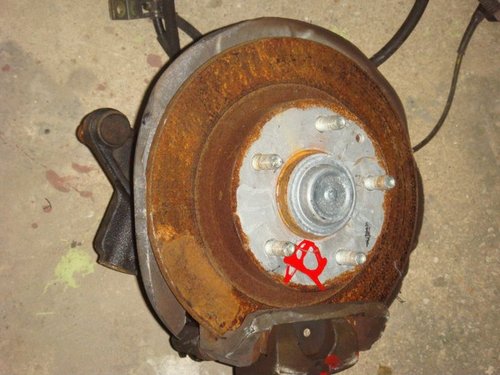

sinister626
Posts: 26
Joined: September 5th, 2009, 4:38 pm
Re: 626 discussion
Postby sinister626 » April 25th, 2011, 6:29 pm
Weeeeeey! Dat a nice 626 dere guy! Das exactly d height I want mine. If only d road by me was nice like by you. Like I have to move yes!
Well I did try the BJ setup from the Sport 2.0 which ppl say should work. Only to find out after the mechanic install that it could not camber or align but it was just ah case of wrong mechanic doh. After I took it back out I got an opinion from ah tuner (BIG difference) which he told me it could have worked if d dodo had shortened the trailing arms. Everything else was bolt fuh bolt doh. The sport 2.0 apparently wider at the back as compared to the other BJ models.
The next problem i had was ride quality, the 2.0 hubs are thicker and heavier than the MX hubs. Mind you I had the original mazda 16 rims from d 2.0 as well eh. Idk how men does take da hard ride nah but i take out that an went back drums an 15's 1 time, no regrets. Did I mention d loss of power? So now that i get the GT brakes, which is lighter than the 2.0, I sell that faster dan ah piper teefin mango.lol. So I hopin to put on soon now that I runnin gears with my carby too...
Sport 2.0 5 stud rear disc brake.
Notice the difference where the trailing arms bolt up.
