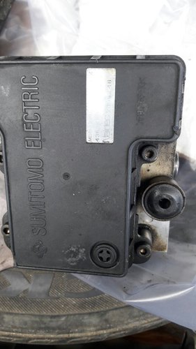

Hey guys, anybody ever change the abs control module on their singapore 323 F ?
Friend of mine changed his because of a leak and now his speedometer and odometer not working.
Any suggestions fellas?

tim69tt wrote:Hey guys, anybody ever change the abs control module on their singapore 323 F ?
I am having the exact same problem. The abs brain is on the pump and the 323f Singapore and Japanese brains seem to have differences. The speedo in this model relies on an abs wheel speed sensor for the speedo signal. So you must get a local/singapore abs pump to fix that issue. I tried 2 foreign used pumps and still the same issue. Try unjacking the new pump, jack in the old one and the speedo should work again, just you would have to find a safe spot to strap the old pump near the new one if you intend to leave in like that.
Hey, were you ever able to solve this problem?
the exact issue has recently popped up on my mazda 6
