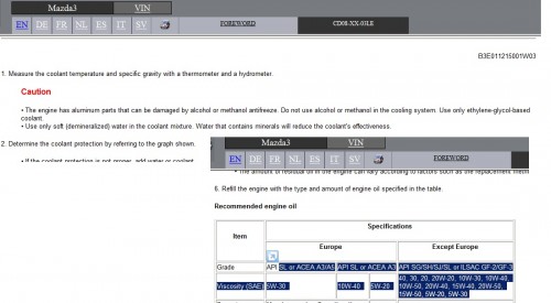

The OEM manual recommends ethylene glycol coolant, the prestone 50/50 is basically thee same formulation as the mazda fl22. i got my car doing 30000kms and used prestone 50/50 in it all the way up to 150,000kms when the car was sold. I never encountered any problems. and just for information sake, mazda does not make coolant, they just rebrand the coolant from their supply companies

I also use 5w 40 shell ultra (wrong weight for our climate) oem filter and air filter. Premium has a better performance tho. Anyway keep ur car good and it u'll enjoy it.

Again you're making it sound as though you HAVE to use fl22. The OEM service manual states clearly:
to use an ethylene glycol based coolant. An no where in the service manual does it mention the use of 5w-40.

Difference between FL22 and Prestone 50/50 is the number of miles you can run them for. It's in the manual. FL22 can do just over 100,000 (funny how Amazon says 60k) and Prestone around 60,000. I change coolant once per year out of habit and I don't do 60k per year. So basically if you don't want to have to think about coolant ever, go buy Peak Long Life because that can go for 150,000. Paying $210 plus hazmat, shipping & customs for FL22 does not appeal to me at all and it's unnecessary.
5w/40 is the wrong engine oil. Plain and simple.

Guys a little note the coolant u need to use has to be borate and silica free one of the few local coolants is zerex asian formula. The toyota stock coolant also is borate n silica free

Rainman wrote:
snight01 wrote:Personally, the car runs silent with no extra vibration with shell ultra 5w 30 at accelerating.. I've used all body oils (10w-30, 10w-40 etc) and all brands from castrol, amsoil, royal purple.
I've planned to try 10w 30 sooner or later but i'm still with 5w-30. I only use OEM oil filter. I've tried fram ONCE. Terrible. Changed it after 5k to OEM.
This is my personal experience and my car. If 10w 30 works fine with you. Most likely it will, then continue to use it. I'll try it next oil change and see examine the performance.
The durability and strength of the OEM parts is amazing. Engine mounts, cradle arms, cv joints and brakes, wheel bearing come to mind.
I go oem as much as possible when the part needs replacing. When the kyb gr2 dies out. I'll order pairs of the OEM.
As i said, to EACH HIS OWN.
You're contradicting yourself now.....you said that you tried all oils, brands weight etc...but then went on to say that you plan to use 10w30 sooner or later. If you're getting vibration from using a different type of oil then your car isn't running as well as you think.
Just out of curiosity, how did you come up with that weight of oil, seeing that it's not recommended or even mentioned in the OEM service manual? your car isn't special or unique, they're all built the same, there is a reason why there are recommended standards.
To each his own, yes. But you can't give biased advice based on your own experience, especially when that advice is wrong.
i'll stick with 5w 40 for now. Whatever you guys wanna recommend, whatever its all opinions. My car and my rules.Works perfect and i see no flaw. I guess you guys gotta learn ur car your own way yes..

snight01 wrote:
Umm...no it' snot opinion. It's fact based on the OEM recommendation. I've posted my reference, where's yours?

Just a question - why do you guys use those lighter body oils in your MZ3?
If I recall the diagram in the manual, the correct body oil for our climate is 20w-50 or 15w-50 (too lazy to go outside to get it now).
Aren't the heavier oils supposed to offer better protection (albeit at the expense of some loss in power)?

dredman1 wrote:Just a question - why do you guys use those lighter body oils in your MZ3?
My manuel said nothing about 20/50 oil...that might be too sluggish
