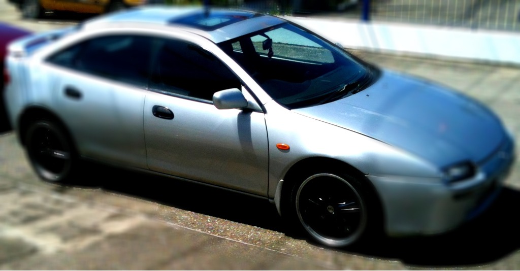

yea i have a mazda 323f sport / Lantis / hatchback, i currently hav a B6 1.6L Eng,Auto Trans. i'm considering lookin to purchase a BP 1.8L Turbo.
Questions:
Has any1 done dis b4?
Can it wrk with current transmission?
Will the BP Eng & Gearbox line up in d car without a million mods?

it is a direct swap but you have to find a FWD bp gearbox

or it'll bolt up in eng bay gd but wont wrk with my current transmission?

I dont advise a bpt on a tranny you will have to buy a few!!! Lol plus the engine came manual only
