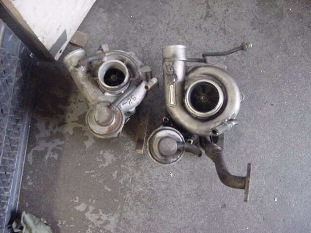

ok ppl by surprise, and I was not even looking for it I got the legendary Knight Sports RF320 Turbo. Now if you remember I have the Knight Sports 4-beat ECU that works at .9 bar (12.7psi). This turbo is MADE for this ECU and set at .9!! i even removed my boost controller, don't need it anymore. the car is crazy and i think i good with the power output. NOW
I ready to do body work, I only putting it off yes!
The turbo was a direct bolt in with just the turbo intake piping had to do over to 2.75" from 2" because of the larger compressor wheel and housing.

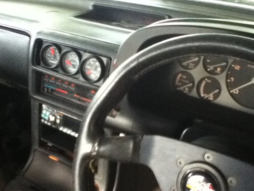

Postby MAZTUNE » February 13th, 2011, 4:29 pm
ok so got my hand on some new gauges, Autometer ES line. They lightup red, I wanted something close to the stock lighting which is amber. Bought boost,water temp in C and oil pressure. Using a Glowshift pod that fits directly in a DIN (deck space) i fit the 3 where the AC vents were facing slightly right towards me.
