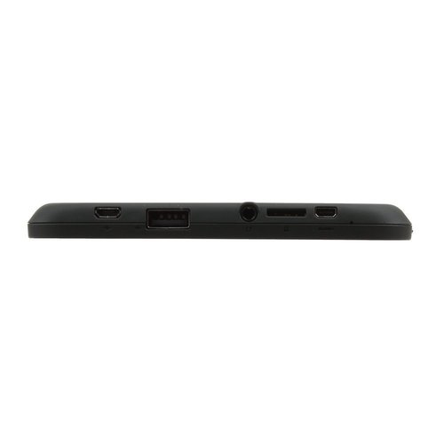

Postby EEng » September 12th, 2015, 10:10 pm
Winbook TW700, cheap brand but I guess would work fine for a single application such as logging and has multiple USB ports. Was considering this sometime ago

Postby Lance » September 13th, 2015, 2:06 am
I actually have one of these. I might hack it to hardwire an external power button to it.
This is my best option thus far.

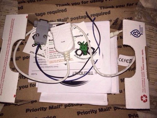

Postby Lance » November 12th, 2015, 5:06 pm
What wideband setup are you using?
Posts: 5928

^ running an AEM UEGO WB - it should have an analogue voltage output that i can set up on a 2.5mm jack and plug into the tactrix....
did some testing with a smaller card....results as follows:-
4GB Kingston card - class 4 formatted to fat32 with 16KB packets
8 parameters logged (same as with 32GB) - same 0.075s per clock (13 samples per second)
edited the logcfg.txt to just 4 parameters - RPM, Timing, AFR, Boost
got the sample clock to 0.03 seconds
added a 5th parameter - knocksum
sample clock 0.04 seconds - which gives 25 samples per second resolution
i will retest with a larger 32MB card to see if i can get the same sample resolution with the 5 parameter selection.
I was unable to format to fat16 using windows XP or windows 10 ...
still have to resolve the AFR log - getting a constant value on the narrowband regardless of what the external wideband (the one used for tuning) says...
hope this helps someone oneday...
Lance
Posts: 2736
Location: Arima<->Leeds
Re: The Tuning Thread- EJ Motor
Postby Lance » November 13th, 2015, 3:12 am
This is good information.
I've never actually did stand alone logging from the tactix, it's always been with romraider. But I can definitely see the advantages of standalone once you can get the wideband setup correctly.
For a/f logging with the aem I just went the traditional way with a serial/USB cable
