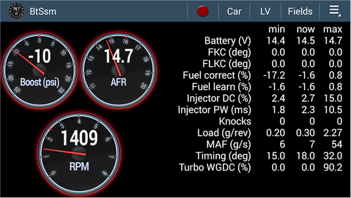

Pirate wrote:^^^ bought a cable like that and can't seem to get it to connect. Tried various COM ports and configurations.
:cry:
make sure your subaru uses SSM over k-line. I have both the vag-com cable which uses k-line and an obd2 cable. The ELM obd2 cables sold use the standard obd2 commands, SSM is proprietary. The vag-com allows you to send the serial SSM commands. I use an android program called BTSSM with a USB OTG adapter. I suppose you can use torque pro as well but the version of cable i have doesn't use an FTDI chip so I haven't been able to test torque pro. You can get the FTDI vag-com cables on ebay.

Are those all the parameters it is capable of reporting?
EEng
Posts: 21
Joined: December 15th, 2009, 4:40 pm
Re: The Tuning Thread- EJ Motor
Postby EEng » August 21st, 2015, 11:02 am
Yep it can and the person who make the app always throwing out updates, it have a thread on legacygt.com for it I believe. If anybody have a tactrix (it has an ftdi chip) and a rooted android you could probably try torque pro. Torque pro could give you live graphs but you need to change the protocol to SSM. The only issue i had with the cheap cable i bought is that sometimes my airbag light comes on, not sure if is the app or the cable. Some of the folks on the thread for BTSSM say that it happens probably when you try to monitor too many parameters.

If you try to log too many parameters its messes with the resolution anyway so its best to keep it to a core set of informative parameters.
Overall this is a good android based alternative. Had I know about it I might have gone this way. Then again it would have restricted me to only logging.

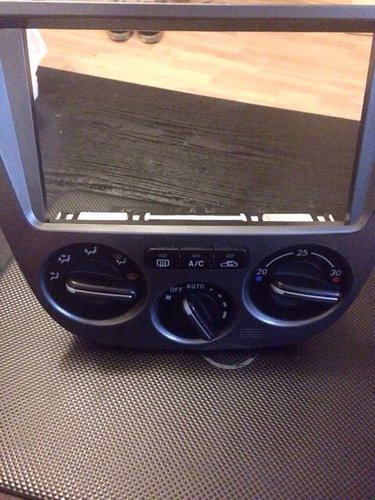

I just picked up a spare stereo cluster to hack up in order to mount the screen.
Taking me back to my car audio fabrication days. More than likely I will relocate the climate controls (since they are electronic controls) and fab an extra single din under the double din spot. The double din will be used for the carputer screen.
