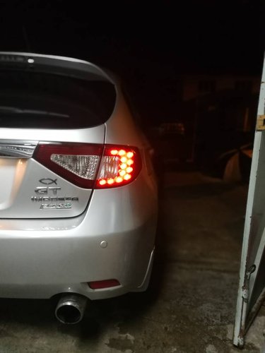

Not really tuning but i honestly believe I got 2whp from painting my lights lol

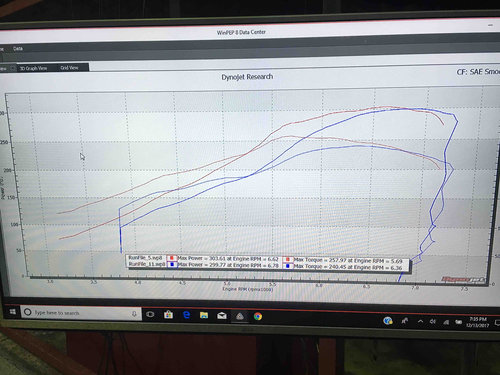

Its amazing the leaks that you find when you do a pressure test.
Even more amazing is how those seemingly tiny leaks affect performance.
Blue line was previous dyno session.
Red line is after fixing those leaks. Top end is slightly lower due to slipping transmission.
2nd gear pulls
