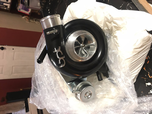

i had a vf37, but upgraded to blouch 1.5 xtr twin scroll.
Still doing the install among a few other things, should be on the road in a week or 2.

Where did you get the turbo
TheBoostLord
Posts: 989
Re: The Tuning Thread- EJ Motor
Postby TheBoostLord » September 19th, 2017, 8:54 pm
ordered from blouch..

Finally got it running. sprang a minor oil cooler leak on the dyno so i have some little things to do.
It made 299whp on 18psi. injectors @about 54%. Turbo hasnt even begun breathing yet. Spool is kept in check so as not to kill the trans. Ryan strongly suggests i upgrade the transmission or swap a gearbox before he does anymore, so until i decide, i have a very capable DD. Its so much more fun to drive.
Car is unbelievably smooth. ID injectors are much better than stock. idles likes butter and the car is noticeably quieter on WOT.
Needless to say im very happy with the result.
Now onto the ez30 forester!
(Pulls were done in 2nd gear, so low numbers but road tune on 3rd)

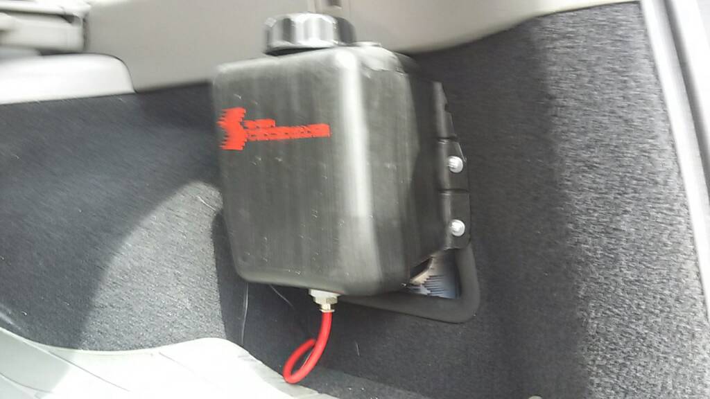

TheBoostLord
Posts: 989
Postby TheBoostLord » November 9th, 2017, 9:17 pm
Legacy update: Found that the wastegate and bov were opening during low throttle. Also started leaning out bad at high rpms. On advice of the tuner i replaced fuel pump. previous owner said he put in a walbro but i pulled out the stock pump..figures. Filter was quite dirty too. replaced with a dw65c. Adjusted wastegate and bov and the car feels like a different animal. I wanted to replace the stock intake with a grimmspeed unit but ill hold off anymore engine mods for now as the 5eat days are definitely numbered. I already have a 6 speed dccd box waiting to go in but have to finish the forester first.

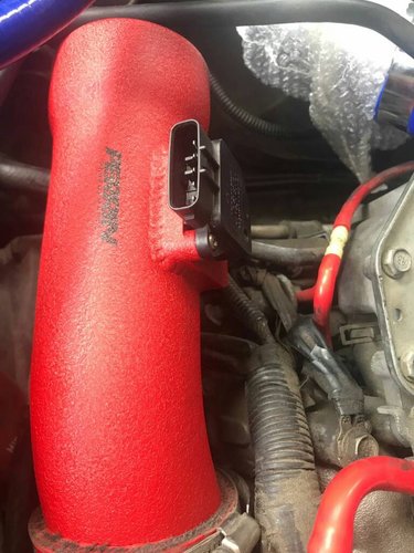

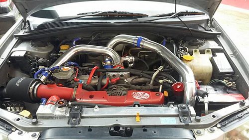

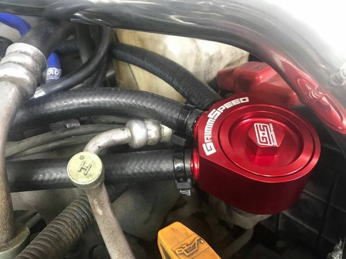

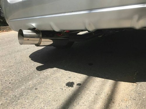

I recently put my foz through some upgrades as well

Postby Animal Pak » November 10th, 2017, 2:49 pm
On stock td04 makes a lil over 200
TheBoostLord
Posts: 989
Postby TheBoostLord » November 11th, 2017, 8:01 pm
Thats pretty good actually.. i made about 240 on a vf37 turbo. Not really that far off

janfar
Posts: 3367
Postby janfar » November 15th, 2017, 12:41 am
Animal Pak wrote:I recently put my foz through some upgrades as well 20171014_110348.jpg20171014_110140.jpgIMG-20170728-WA0007.jpgIMG-20170914-WA0005.jpgIMG-20170914-WA0003.jpg
Lovely intake. Where'd you get that from?
