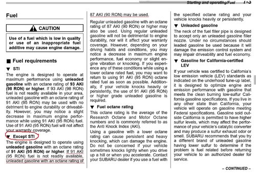

Postby gunns » May 22nd, 2016, 9:27 am
I have a impreza brochure that says for wrx and sti 91 RON .
Lance
Posts: 2736
Location: Arima<->Leeds
Re: Premium or Super
Postby Lance » May 22nd, 2016, 2:05 pm
Could you upload a picture of that brochure page?
Pirate
Posts: 1004
Postby Pirate » May 22nd, 2016, 7:44 pm
whap!
Lance
Posts: 2736
Re: RE: Re: Premium or Super
Postby Lance » May 24th, 2016, 4:21 am
Pirate wrote:whap!
Thanks man!
I'm interpreting this as the wrx being fine with 90RON but a minimum of 95RON for the STi.
Makes sense given the beefier turbo setup, boost level and timing maps on the STi.
Is this from a Singaporean manual by chance?
Pirate
Posts: 1004
Postby Pirate » May 26th, 2016, 11:11 pm
This is supposed to be from the USA Manual
