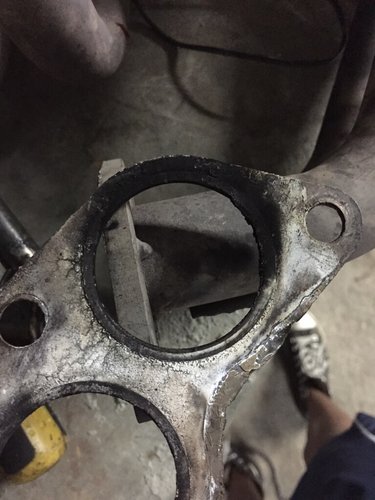

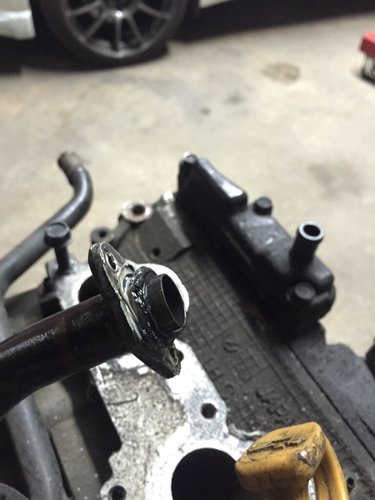

Postby TheBoostLord » May 18th, 2015, 6:44 pm
Update on low oil pressure: so I've been driving around since, and the past few days oil pressure has dropped to dangerously low levels hitting 6,4 and even 2 psi for fractions of a second while slowing to a stop. Parked up the car this afternoon and pulled the oil pan. Both bolts on oil pickup were loose and the o ring on it was completely shredded, with hints of silicone around it as if a repair was attempted. I replaced it with my killer b pickup but haven't mounted the pan back on yet. Will update with pressures when I do but I believe I've found my low oil pressure problem
Re: LEGACY GROUP TRINIDAD; THE PLACE WHERE WE MEET ;-)
Postby Ted_v2 » May 18th, 2015, 7:15 pm
Dang son. You just saved yourself plenty engine woes
TheBoostLord
Posts: 989
Postby TheBoostLord » May 18th, 2015, 7:28 pm
I also found a pre turbo exhaust leak. Time for more spool :D
