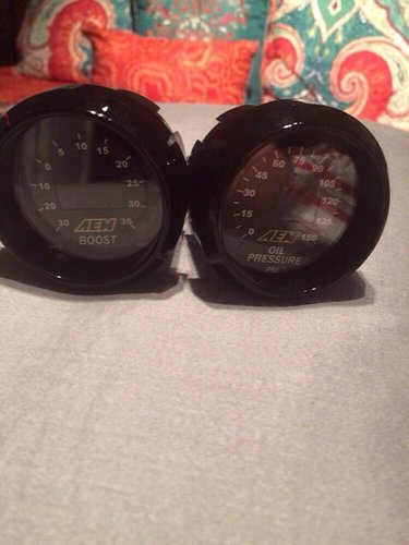

Making the switch to some digital gauges. I've been finding it hard to keep track of the analog ones I have now.
Got a deal on two. The boost was missing the sensor but I will probably just tap the 3.5 bar aem map sensor that I have on the car now for speed density. It's basically the stainless steel version of the brass one that aem ships with the gauge.
Aaron 2NR
Posts: 6476
Re: The Tuning Thread- EJ Motor
Postby Aaron 2NR » March 28th, 2016, 5:50 pm
Most of mine are digital as well. A lot easier to monitor at a glance.
Only analogue I have are the water temp and oil temp because they are elite series autometer with alarms and they match my dash panel too...
Lance
Posts: 2736
Location: Arima<->Leeds
Postby Lance » March 28th, 2016, 6:22 pm
This is why I'm going digital as well.
Before, the extra time to process the needle and align it to a number wasn't too bad.
It's starting to be a issue now though, to a point where i don't feel it's safe anymore.

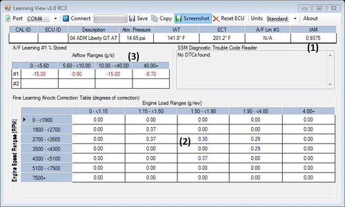

I've have been using learning view for some time now- since 2011 (up until this version of my ROM). I really can't stress on how useful it is as a tool to monitor and detect mechanical and electronic (ecu tuning) issues with your vehicle. I just wanted to provide a brief overview on how I interpret a typical learning view and what areas I usually pay attention to. I would also like to highlight some of the misconceptions floating around- especially as it relates to the a/f learning tables.
I am no means an ecu "tuner". I'm just learning. I've highlighted the three aspects of learning view that I pay the most attention to when i'm trying to quickly deduce the state of my motor (see screenshot below). I've chosen a Learning View that better illustrates some of the issues that you would need to look out for (meaning this photo is where you want things to be). The three post following this one will address each of the sections highlighted.
Lance
Posts: 2736
Postby Lance » April 21st, 2016, 11:05 am
(1) This is probably the first thing you should look at. The Ignition Advance Multiplier (IAM) gives you abroad idea of the health of motor - as it relates to significant instances of knock. To understand how IAM works you need to take into consideration how Subaru configures the ignition timing on our cars.
Total timing "available" = Base timing table + Knock correction advance table
This is primarily done to provide a safety mechanism for your car. Your base timing should, in principle, be a conservative timing map which can be reverted to in instances of mechanical failure (safe mode so to speak). The advance table is timing that will be added to the car in instances of no knock.
Essentially, IAM dictates how much advance timing will be added across the entire RPM/Load range of your base timing table. For 16 bit Subaru ECU, the maximum IAM will be 16. For 32 Bit ECUS the maximum IAM value is 1.
So assuming that there are no instances of FLKC (we will get to this), If your IAM is 16/1 then your car will be seeing the full allocation of timing (Base+Advance). If your ECU detects multiple instances of knock across the RPM/Load ranges which it cannot control for individually, then it will start to decrease your IAM value until the knock is no longer present. This effectively reduces the amount of advance timing that is applied to your base map. The lower the IAM value, the less advance timing is being applied - signaling increasing widespread knock.
So essentially, a 16/1 IAM means that the ECU is not experiencing widespread knock which it cannot control for.
