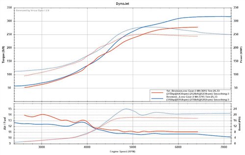

Just a quick update on things (VD estimate).
This is my second WOT pull and the first pull that isn't on wastegate boost (red is wastegate boost). Tuner is currently dialling in the boost pressure. We're more than likely hoping to hit 25PSI and then smoothly taper down to around 23. As you can see from the boost curve, still have some tuning to do on that (Together with the AVCS tuning).
Current map is setup very rich to increase the margin of safety while adjusting the boost (afr is pulled directly from my AEM WB). Timing is very conservative as well. The Tuner will probably deal with these aspects once the boost is set up (not exactly sure what his tuning strategy is but I trust his judgement).
All in all, we still have a reasonable amount of safe power on the table.
Not sure what the final power would look like. The logs are clean right now (no FLKC, FBKC or IAM issues) so I'm keeping fingers crossed.
I picked up a radiator leak on the stocker so I need to sort that out before moving on.
Edit- Better quality graph added (you can begin to see the boost coming on earlier with Revision 2- AVCS tuning)

^ will take a while to dial in...keep at it....
you tuning with meth one time for safety or dialing as safe as possible without meth then adding it in for extra protection?

I'm spraying meth right now on this setup.
A V1 AEM kit with the larger nozzle. It's definitely doing its bit to suppress detonation. Comes in progressively at around 6psi.

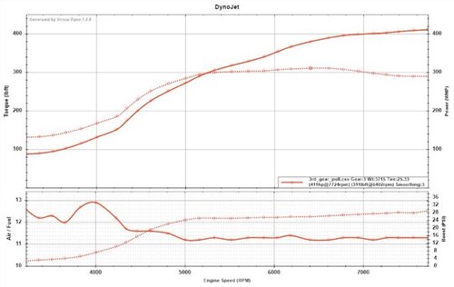

After two additional revisions.
Boost and afr almost dialled in. Just a bit more to do on this end and then we will probably start tweaking the timing, AVCS and smoothing out the top end.
Not sure how much more she has in her within a safe margin. Waiting on the tuner's advice.

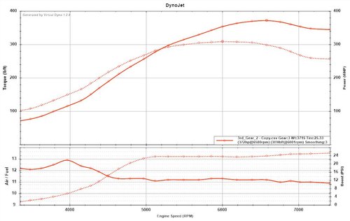

Its been a long time in tuning (over 5 weeks). I didn't mind though, the tuner really spent time dialling in the car and putting up with my nitpicking. I've also learnt a lot in the process. Over 11 MAP revisions thus far across idle/cruising/WOT tuning.
I think we are at a comfortable place with this setup on pump gas. Given the efficiency range of the turbo, it appears that the tuner opted to make safe power with boost rather than timing (for every PSI I was gaining about 10-12hp). Looking through my logs, the timing was always on the conservative side. I think on a Race Gas tune at 30psi this turbo should have no problem putting down 450whp.
The VD dyno attached is where the estimated power level is at (397whp/310wtq). The pulls are consistent and the graphs hold up to the relevant accuracy checks - http://www.evolutionm.net/forums/evo-dy ... perly.html
Once everything is settled I'll take it for a pull on one of the local dynojets to compare.
I have another revision to flash but I suspect this isn't a power oriented edit to the ROM. I hit a fuel cut right at about 7400rpm on the last pull and this map is suppose fix that. We're just addressing that and making sure everything is stable across the gears.

The tuner brought in the boost slowly and ramped it up to the end so that its not too taxing on the motor. So it won't be fair for me to just state a single boost number.
On the final map, I hit 24psi at about 4800rpm and it slowly increases to 26psi until around 6700rpm and then quickly ramps it up to 28psi closer to redline (it's plotted on the chart). He mentioned that the 207s really need a bit of help on top to keep the power from dropping off. This final map produces a virtual dyno estimate of 411whp/311tq.
Today I had Bird take it for a demanding run. IAM solid without FLKC or FBKC. After a few pulls the OEM clutch on the 5 speed is slipping a bit on the upper end of the power band. Something I'll have to address over time.
The only issue I have is that learning view no longer works on this ROM being a Carberry setup (an iteration of the Group-N ROM). I'll have to submit the rom id on the romraider forum so it can be added.
