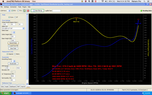

did a VERY conservative self tune on my legacy and tried the road dyno in romraider but ran out of road so i had to lift off throttle early.

Did you back off the throttle right after max torque?
That's alot of torque early on! Either your torque is calculated incorrectly (sloped road?) or you're pushing a lot timing to spool that turbo (stock?) so early.
What's the setup?

Graph only goes up to 5500rpm thats when i backed off. Running a vf37 @ 20psi ,fmic and some other bits. It was super conservative to prevent knock until i get a protune. The 'tune' it came with from the previous owner was insane. knock all over the place an had a huge leak in the water meth system, maf installed by a 90 degree bend and host of other problems. No wonder that motor had severe compression issues.

300tq at 2800rpm?
Have you tried using virtual dyno? It seems to be fairly accurate. Try doing another pull and see if the figures are similar.

oh its also 5eat not gearbox. im guessing the torque converter has a huge part to play. Should be tuned this week though so will report with data.
