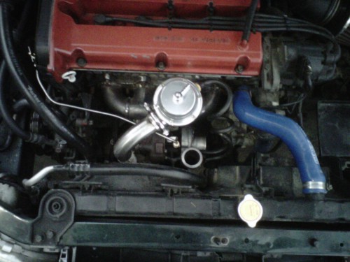

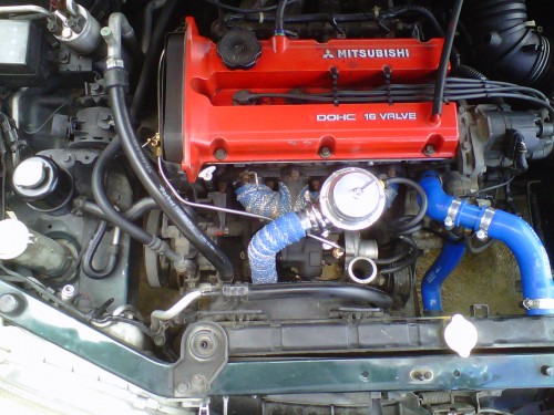

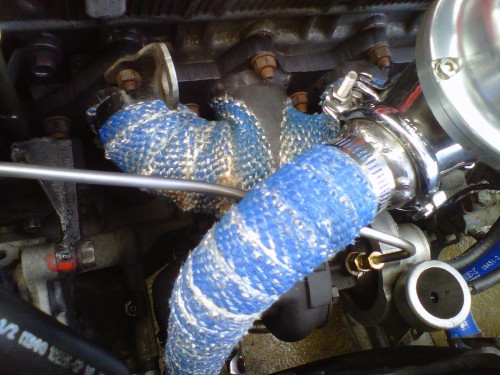

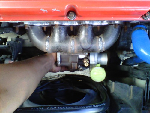

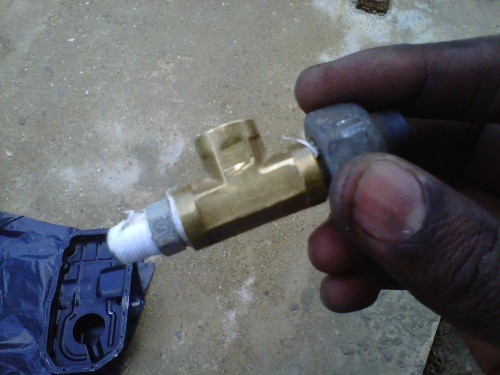

Any pointers will do,I already made the exhaust manifold myself with a T25 turbo an 38mm wastegate 6psi . I have a AEM fic6 to put on just have to do other stuff like clucth,270cc injectors from mivec ect. I am doing most of the wrk myself with help from friends.An my whole exhaust system is 2in.
the car
end result
finish
test fit before welding everything
oil drain
Tee for oil feed
mock up

Re: turbocharging my 4G15 some pics up
Postby Morpheus » January 15th, 2014, 10:18 pm
Nice.
The red rocker cover looking fresh too
