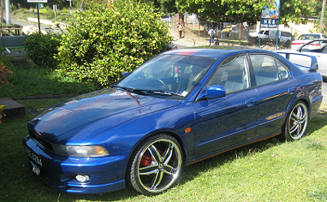

Grip wrote:Thinking about doing a vr4 conversion on my galant vrg, however it was suggested that I use a 4g63t instead of the 6a13dett. I want to know what are the advantages and disadvantages to both swaps also the costs associated with them.
Ok so i was watching an reading what going on an it so happen that i was thinking of putting a 4g63t in this galant but base on what response i saw going wit d 6a13tt engine an looking for a l.s.d f.w.d box to go wit it, anybody could point me in d right direction price wise too?
garage stuff 019.png (383.31 KiB) Viewed 30127 times
