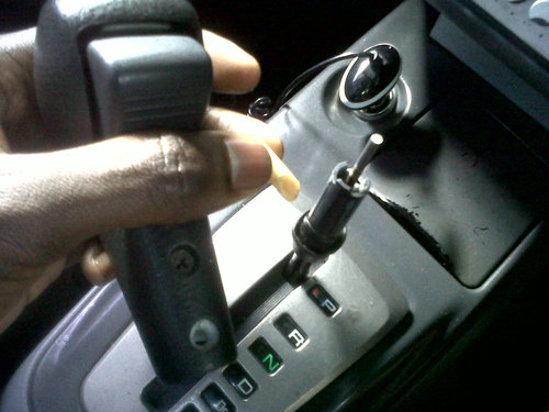

idlemind wrote:BH, unscrew your shifter and see if the cream cap near the shifter button is damaged.
While the shifter is off, see if you can engage park by pushing down the metal rod.
If the cream cap is broken I have a fix for it.
Will check and get back to you.

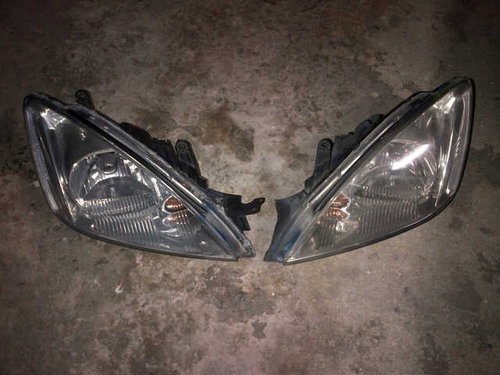

I have a pair of CS3A headlamps for sale. Letting them go for 800.
Just putting this here for any potential customers.

turbo_beast369 and venum, the headlamps are for 2005 CS3A, local. One light is OEM and one was bought from Bobby's which I believe is Taiwanese. They are both in good condition. Below is a picture of the pair of lamps.
idlemind, the cream cap under the shifter IS damaged and the shifter IS moving into the 'P' position with the metal road depressed. How do I repair? I'll be driving the car without the shifter cover for it to work properly until I can get it fixed.

BrotherHood wrote:idlemind, the cream cap under the shifter IS damaged and the shifter IS moving into the 'P' position with the metal road depressed. How do I repair?
change the shifter
get a good one from by Bella and remove the cable connection on yours and swap out
BrotherHood
Posts: 8250
Re: The Official CS Lancer Thread!
Postby BrotherHood » December 30th, 2012, 4:35 pm
Will be in that area tomorrow so I'll give him a call. Thanks.
You mentioned a cable connection, what exactly is the cable connection?

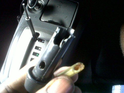

Nope...there's such an easy fix for this I couldn't believe and had to see it for myself.
Get an old spark plug and pop out the tip of the plug that makes contact with the coil packs (not the spark tip)
Replace the broken cream cap with the piece from the spark plug.
Works like an eff'in charm!

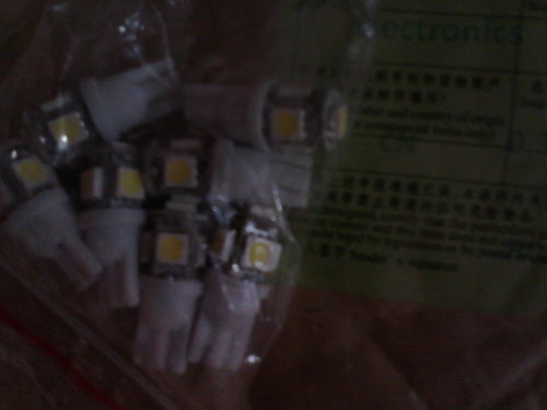

Has been a while since i ve been here,busy so All the Best for the New Year fellas
On another note, i just adding to the forum, decided to light up my biatch life for the year
Bought some t5 and t10 led bulbs online and thanks to venum with some old post which can be found on
pages 14 viewtopic.php?f=33&t=98180&start=390 and
page 114 viewtopic.php?f=33&t=98180&start=3390
i did this. I included the pages for anyone who wants to try.
The pics not all that great caz its from a phone but the sheit looks great and unusual from the stock
Any way this is the sheit.
I got about 6 more pairs of t10(white) if anyone wants to take them from me. I let dem go for $25 a pair which is rel fair compared to the prices down here

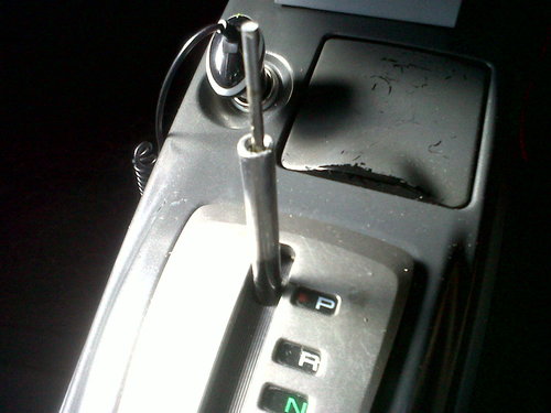

So this is what took place with my shifter that caused it to not engage in to the 'P' position.
So, buy a shifter or use idlemind's spark plug fix?
