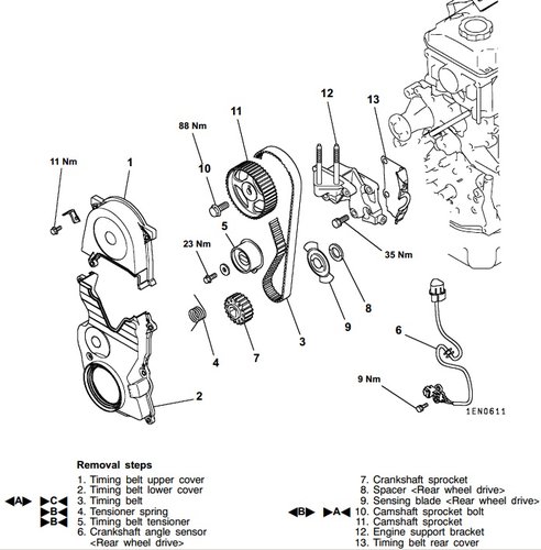

xtech wrote:sorry i am late but when i came across this problem it was nothing electrical.....you will get no codes until the engine starts and the ECU records it.
so in our case the trigger wheel for the crank was loose and was not properly aligned with Top Dead Center (I think its called) so ECU will not know when to fire piston 1....sound like u have this problem and maybe mech dont know how to reset this trigger wheel to correct position.
if it was not doing anything before it was because the trigger was not moving with the crank
now you get spark but its out of timing so engine will not start that means the trigger is moving again
so where the trigger wheel located and do u have pics of it
xtech
Posts: 3004
Re: CS Lancer!
Postby xtech » December 9th, 2012, 7:23 am
Its #9 Sensing blade
only thing our fault was on a 4G93GDI
I dont know where the crank sensor is on this engine
