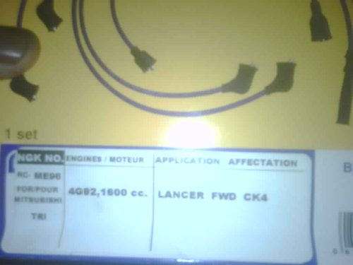

Problem solved.
The seal that you talk about venum is letting a bit of oil pass and wet the plug 1 but the real problem was the two plug wires. Bought them at Autotune Supplies in St. Helena and changed them right outside the stoor. I immediately got the response. I am in proper working order now.
Apparently, the CK and Cs uses the same plug wires. THis one I got is NGK and the box had written on it for CK4 Lancer. Will post a pic tomorrow. Too tired to do that.

^^^. Plug seal changed, Don't want any of my plugs getting wet by oil.
Below is the plug wires I purchased. $145 total at Autotune Supplies, St. Helena.
