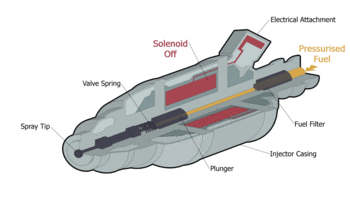

mety57 wrote:hey idle did u ever clean yuh gdi injectors or did the pressure of the pump kept it from getting dirty
idlemind wrote:never cleaned, pressure from the pump is too high for them to get clogged, some argue differently though. But never hurt to try a cleaning and see.
Why Do Fuel Injectors Need To Be Serviced?
1. Fuel Contamination: Can come from any number of sources. A tanker ship that brings the fuel from overseas, storage tanks, delivery trucks, the tanks or pumps at the gas station or even the vehicle's fuel tank itself can deliver small particles of contamination that will clog injector tips. Some fuel contaminants will be stopped by the filter, but some contamination particles will eventually make their way past fuel pump inlet socks, fuel filters and injector inlet screens result in dirty or sticking injectors.
2. Heat Sink: Once the engine has stopped running injectors themselves effectively become a heat sink area. Heat will bake the oilfins into hard varnish deposits. Over time, these deposits will build and clog the injectors. On four-cylinder engines, the #2 and #3 injectors are in the hottest location and tend to clog up faster than the end injectors on cylinders #1 and #4. The hotter the location, the more vulnerable injectors are to clogging from heat soak.
3. Olefins: Fuel injectors become restricted or plugged when olefins (substances found in gasoline), which are heavy, waxy compounds. When the engine is shut off, the injectors undergo heat soak. Fuel residue in the injector nozzles evaporates, leaving the waxy oilfins behind. When the engine is shut off heat from combustion chamber area heat sink components such as pistons, rings, cylinder heads will transfer and travel to colder areas such as fuel injectors.
4. Driving habits: Heat sink injector plugging is typically more severe on vehicles, which are driven on short trips (15 minutes or less) and the allowed to sit for 45 minutes creating a heat soak environment affecting the injector pintles and nozzles. This scenario is very common for city-driven vehicles.
5. Minute Tolerances: The metered orifice of a pintle valve fuel injector is approximately .002 inches. Approximately the size of a human hair, it is highly susceptible to plugging, even from minute contaminants. Once plugged or restricted, the injectors must be serviced (cleaned) or replaced.
6. Injector Leakage: Fuel rail residual pressures can result in injector leakage when contaminants are present which may keep a pintle from fully seating to a closed position. A seeping injector, complemented by intense heat (heat soak), will eventually result in a totally restricted injector.
7. Symptoms: It doesn't take much of a restriction in an injector to lean out the fuel mixture. A restriction of only 8% to 10% in a single fuel injector can be enough to cause a misfire. Injector flow tolerance between individual injectors on the fuel rail should be less than 5% across the board! Injector plugging symptoms may involve a miss, rough idle, surge or high emission output. With the metered orifice in the injector nozzle the diameter of a human hair, and a deposit buildup of even just 1/10th that thickness performance problems are inevitable, even with minor restrictions.
8. Carbon Build Up. Mostly found in GDI motors that have injectors inside the cylinder here they face extreme temps and combustion pressures. By products like carbon build up on tip of the injector forming a hard shell that eventually covers he nozzle and interrupts the optimal spray pattern. Injectors need to be removed and the carbon brushed off.
