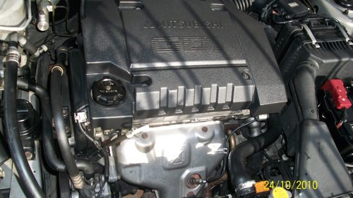

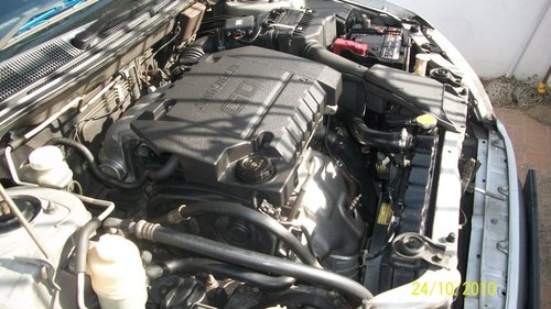

Postby ronsin1 » October 25th, 2010, 1:41 pm
I need a tappet pan seal for the 4g15 GDI engine I have an oil leak and meh engine getting dirty and anybody that knows me well could eat of the engine
see pic after the engine wash

turbo I never changed plug seals, allyuh padna RC tell me it will cost $8k to do that
ronsin1
Posts: 3671
Re: CS Lancer!
Postby ronsin1 » October 25th, 2010, 4:44 pm
EVA Unit-01 wrote:^^^or i cud check tom, as is nex door... jes sayin!
price and where I could meet you
The engine to clean for oil to mess it up :cry:

CS3A_GLX wrote:padna, an engine is no place 4 water eh! sum WD40 and a cloth!
well will disagree with you is how you get it washed once you cover your alternator, MAF and ensure your coil packs do not get wet you good to go.
also ensure you engine is not hot when you washing it.
there is a thread on how to wash your engine somewhere about the forum.
I have been washing the engine in this car since I bought it.
ZeroOne I had the guys next to Federal on Ciepro street wash the engine this time I normally go to the gas station on Royal Road in San Fernando to get it done but at the time of the Day it was not possible.
