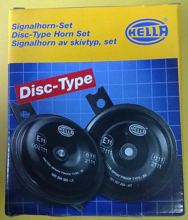

Hi guys, do you have any idea if CS3 has a horn relay in place ?
I checked out the electrical drawing of EVO 9 and found out that a horn relay is there but am not sure if the horn relay is available in CS3. As I would like to install a snail horn and would save myself of installing additional relay and wiring.
thanks
ronsin1
Posts: 3671
Postby ronsin1 » February 8th, 2010, 11:43 am
if you are installing an additional load i.e. horn and pulls a high amperage than the stock horn you should use a relay. As the Stock system can only handle the capacity of the stock horn.
you will end up blowing fuses or burning the contacts on the stock relay

Hi ronsin, I am replacing the stock horn with a pair of hella horn driving about 6amp in total. I'm not sure how much a stock horn is driving thou.
Any kind soul can share the electrical drawing of CS3 ? The drawing I saw in EVO has a relay with a fuse of 10amp.

if the two hella horns driving 6 amps total then u safe becuz the CS3 uses d same horn amperage as an EVO....send a pic of the hella horns u want to put....I doubt u hadda put a relay if you replacing d stock horns...

hi turbo, here's the specs of the hella disc horn and pic. It says max 3.5A but I ain't sure if its based on 1 or a pair of horn but I'll take it as 7amp in total so that should still not exceed the max 10A horn fuse
Specification
Voltage = 12V
Current consumption = 3.5 Amp (Max)
Frequency:
Low Tone = 350 Hz
High Tone = 420 Hz
Sound pressure = 118 dB(A) (at 2m from source)
Resistance = 3 m/ Ohm min @ 500 meger
Type of sound = Disc Horn, Metallic
Life durability = As per IS1884:1993
Weight = 310 gms
(without brackets)
Dimension = 90 mm
Part No. IAM092-02
turbo_beast369 wrote:if the two hella horns driving 6 amps total then u safe becuz the CS3 uses d same horn amperage as an EVO....send a pic of the hella horns u want to put....I doubt u hadda put a relay if you replacing d stock horns...

cdetat if you jus replacing your stock horns with those then its a simple plug and play...I thought u was talkin bout an air horn with mini compressor...there is no need to run a bigger relay...
