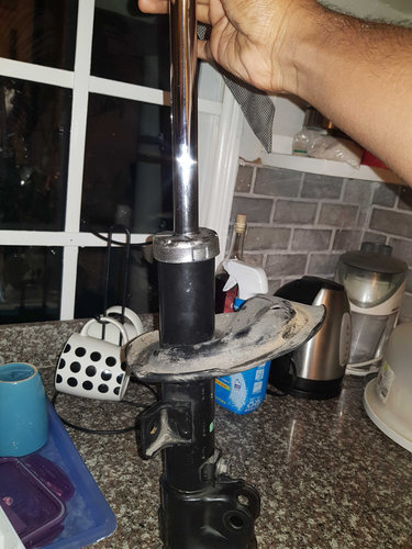

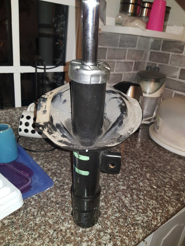

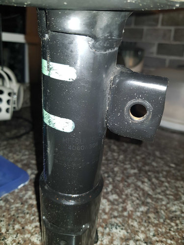

Hay guys really need some assistance again for my Galant fortis Sportback.
I'm trying to find replacement shocks for my car but every place I tried giving me a different type and nun really have the brackets on them. I attach some pics
Can anyone tell me if I can get them in Trinidad and where please pls.
shock3
shock2
shock1

Kyb 339104 you could call around and ask for that. (dollar savers first) It should fit. If not order it online.

On my 2008 Galant Fortis CY4A, I installed KYB Excel-G 339118/7 on the front, and KYB 341455 on the rear. I got them at dollar savers.
Also, according to KYB's fitment guide, the Excel-G 339083/2 & 341425 fit the US-spec 2008 Lancer GTS, which is more or less equivalent to the GT model.
In any event, dollar savers were the authorised distributor locally for KYB, so you could ask them. I think spirited721's lancer is the 1.6. My car is the 2.0, hence the different numbers. Not sure about your car.

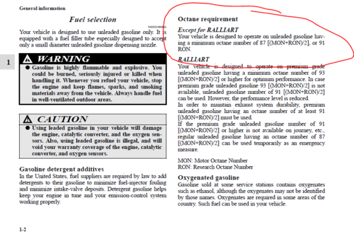

Evening fellas, reading through the thread i seeing that the 1.6L has to take premium, but when i reading through the owners manual it makes no mention of that.
Dealing with the 2013 1.6 4A92
https://carmanuals2.com/get/mitsubishi- ... nual-36809
can be retrieved here, just search the pdf for "fuel" until you reach the page

On my gas tank cover it says premium unleaded
