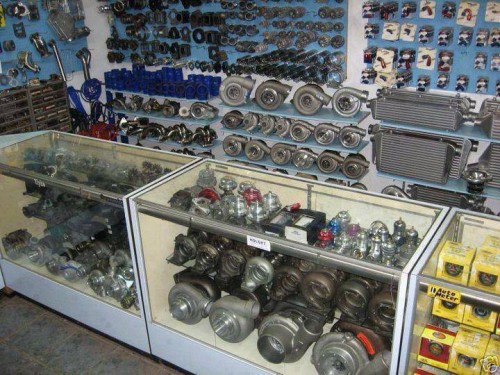

Any turbo you need is available in this shop

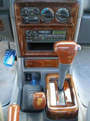

Postby INDAVID WORKSHOP » May 9th, 2014, 8:27 am
Wood grain interior you can love

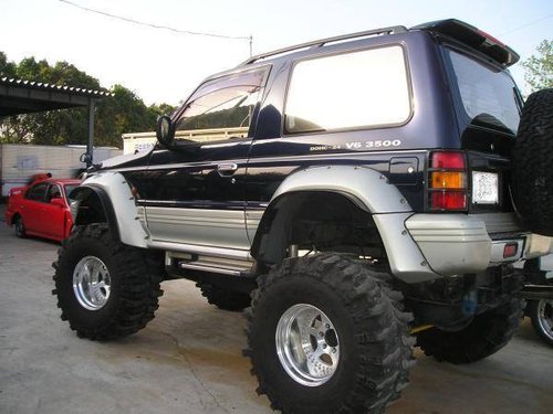

Postby INDAVID WORKSHOP » May 9th, 2014, 8:28 am
Offroad ready.
