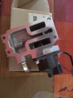

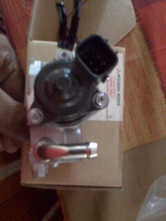

A friend of mine sourced the throttle body for me, $1800 TTD landed, brand new, installed and issue is resolved.

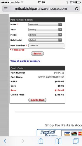

Postby TriniAutoMart » March 1st, 2016, 11:28 am
JUS4SHO wrote:step up sensor?
you mean the idle speed contorl valve / motor is so its a very commy problem with all mitsu's that these ISC fail.. for the cs3a the p/n is MD619857
I called Diamond Motors and they gave me p/n MD619879.
Which p/n is correct?
JUS4SHO
Posts: 9662
Joined: April 22nd, 2003, 11:06 am
Location: N/A
Re: 4G18 IDLE PROBLEM
Postby JUS4SHO » March 1st, 2016, 6:31 pm
JUS4SHO
Posts: 9662
Location: N/A
Postby JUS4SHO » March 1st, 2016, 6:32 pm
JUS4SHO
Posts: 9662
Location: N/A
Postby JUS4SHO » March 1st, 2016, 6:34 pm
This is the last info I had on this from 8-9 years ago
TriniAutoMart
Posts: 1283
Postby TriniAutoMart » March 2nd, 2016, 1:13 pm
Is there anywhere to source this item outside of Diamond Motors?
JUS4SHO
Posts: 9662
Location: N/A
Postby JUS4SHO » March 2nd, 2016, 5:20 pm
