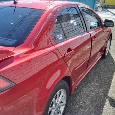

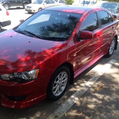

Here's some pics of Jenny :oops: Enjoy!! So another thing. Today i went by car boutique to upgrade wheels and rubber and lo and behold my front right wheel has a stripped stud and bolt :| You can imagine my disgust. Four bolts off completely and this one just spinning. Anyone know where and how to fix this? i definitely need an experienced mech for my baby :(

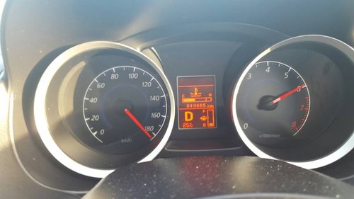

Normal with the gt

Nice...
I hit 225 in mine but ran out of road ;-)
