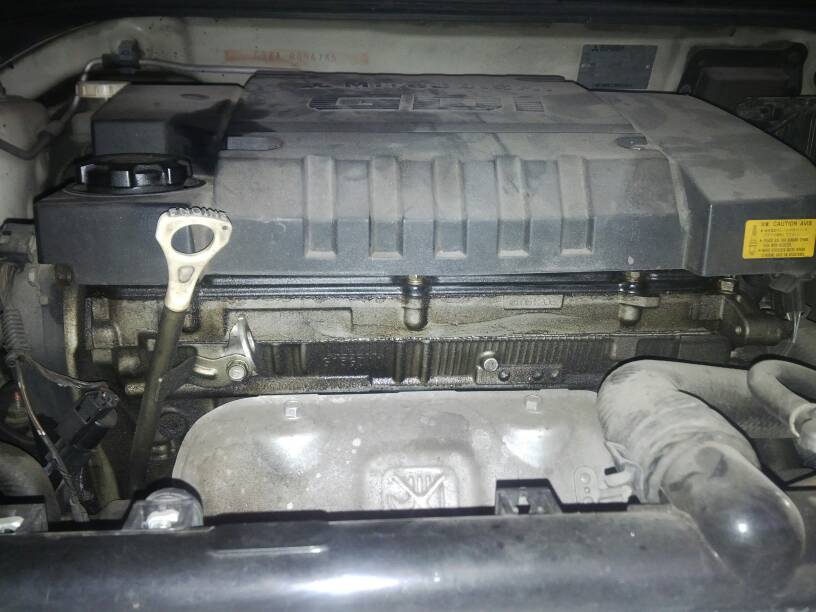

Engine leaking oil, mechanic recommending me to change it would you all give the same recommendation or should I fix
Thanks in advance

Leaking from where?

trini iceman wrote:Leaking from where?
not sure exactly but it seems to be at the front where a seal is

Front? As in timing side? If the engine never overheat badly I say take a chance. If it has then you should consider seal kit.

trini iceman wrote:Front? As in timing side? If the engine never overheat badly I say take a chance. If it has then you should consider seal kit.
Please see attached

Rocker cover gasket? Just where the black part ends? Those leak all the time. The mechanics said change the engine for that?

rofl @ change engine for bad rocker cover gasket lol.....that mechanic does not know anything about the GDI engine.
Oil burning can be through the valve seals or piston rings.....what engine we talking about here? And if the plugs come out with black soot on them then the oil is burning in the combustion chamber.

Most times, the plugs comes out white, jus d threads of d plugs does have oil. 4g18 engine. No leaks nun, it jus disappearing

If the plug thread has oil there is a leak from the plug seal.
Time to change plug seal/gasket.
What grade oil you use?

Forgive me not sure if all the comments above was directed towards me
So I should change the rocket cover gasket to see if it solve the problem?

Yes there are 2 rocker cover gaskets you have to change.
What mileage that engine doing?
