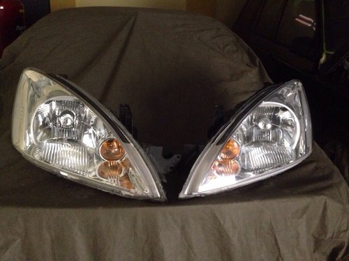

PhotoKID
Posts: 17
Joined: May 22nd, 2013, 8:17 pm
Re: The Official CS Lancer Thread!
Postby PhotoKID » September 15th, 2015, 5:01 pm
For sale: used pair of cs3 headlights. Want it gone offer me something.
