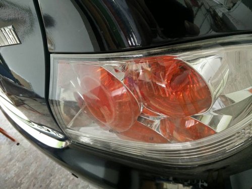

Yeh fellas umm possible to open and fix or just buy a new set :-( ... All sorta falling out because umm subs :lol:
Re: The Official CS Lancer Thread!
Postby gastly369 » June 30th, 2015, 6:41 pm
OK so I drilled on top about inch away from lens stuck a screw driver in and snapped back the red insert and plastic sealed the hole ..good to go

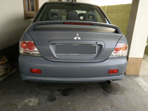

Postby Monk BANzai » July 2nd, 2015, 12:37 pm
ok.. heres pics of the set. Also I want to trade the rear lights for a set of the all red ones. If anyone wants a set of Ralliart (i guess lol) Tails let me know. Condition of the traded set must be good though.

Postby Monk BANzai » July 2nd, 2015, 1:38 pm
not sure if its the only one as ive seen others with the headrests setup. But very few. yeah 4G63 Non-turbo..

^^^ ditto... well meem no Mitsu expertz like allyuh... so i is learning..... and those aren't bumper reflectors... they're rear fogs...
Ditto on both accounts Kjag and Morpheus.... same car. with this interior...

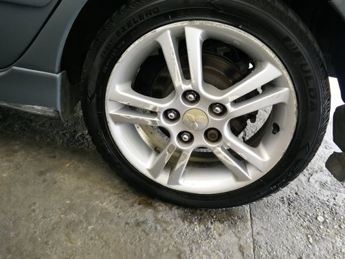

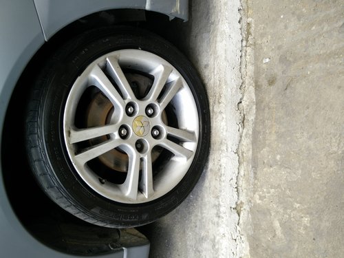

Postby Jade_Inc. » July 6th, 2015, 9:59 pm
My steering keeps shaking a little. I aligned, speed balance, changed front tires, a front bearing, 1 side rotor and both cradles.
my steering end and tie rods looks good.
Could the rotor cause the steering to shake when i reach around 90km+?

Postby Dave » July 7th, 2015, 4:36 am
Swap rims front to back

Postby ZeroOne » July 7th, 2015, 8:10 am
Front rims bent.
Usually you see a bent rim when speed balancing while the rim is turning on the balancing machine.
Also if the machine is not calibrated properly and the technician is not well trained, the rim may not be balanced even though the machine says so.
Have that problem right now, machine says the rims are balanced but at high speed the shaking of the car says otherwise.

Hmm...I'll go back by the tire shop and let him check it again....while turning a corner I found the car to be shaking also ... Mostly around 40-60km

So I went by the tire shop a while ago and one of mY front rim is bent. Problem temporarily solved..one of the back rim is in front now

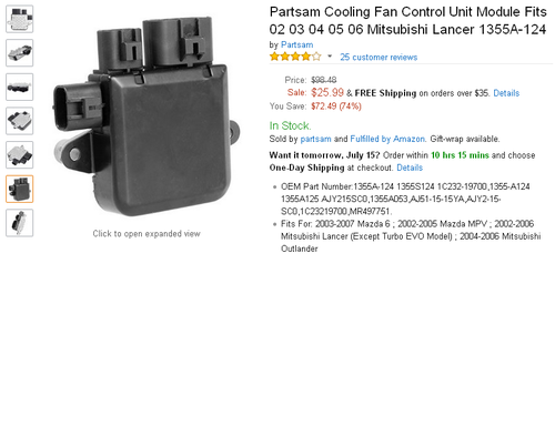

Postby 30hz » July 14th, 2015, 7:35 am
found this on Amazon
works great!!!
