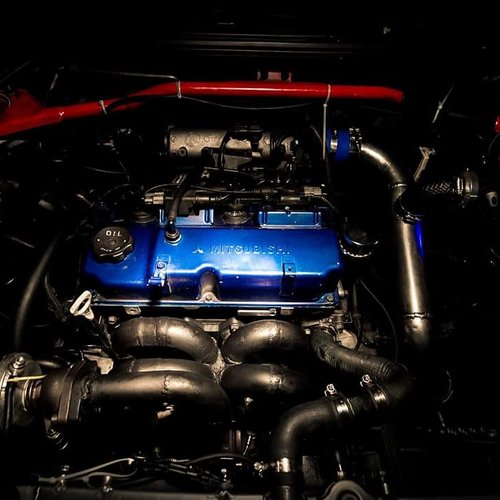

So my friend and i decided to turbo charge my 4g18. This is the finished product. Car is tuned on 5psi right now on super. Car pulls really nice at the moment!!!I'm using an AEM FIC management, external waste gate wit a 5 psi spring an many other stuff. Still got some fine tuning to do to get her ready for drag an wind next month. Will be going up to 7psi for now. Any questions feel free to ask

turbo?
injector size?
maf or map?

Td05 from an older model vr4. Using stock injectors now. But i have gsr 390cc injectors to put in if i need. Map sensor. The aem fic has a built in map sensor that reads boost. I can link yall with the guy that did d manifold. Very reasonable

What transmission?

Car came original manual

Which sensor you using map or maf?

Thanks morpheus. I'm using map sensor ted

Heard great things about the rc injectors.
You tee off the oil unit and drill the sump? For oil flow
What about coolant Lines. The rear heater lines?

OHh yes, looks damn good.
The front looks more aggressive now with the intercooler behind that ralliart front bumper.
Well done Daniel.
What kind of paint was used on the cover there?

Thanks brotherhood. I used d duplicolor paint. You have to use the silver base coat with it as well.
Ted,we tee'd off the water lines to d back. Not d heater lines. I have an oil cooler relocator kit on the car as well,an it has two extra ports,so we ran the turbo oil feed line from there and drilled an weld on a connection on d sump for d oil drain
