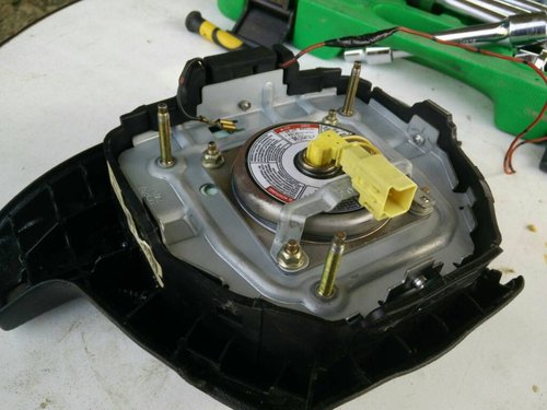

Re: The Official CS Lancer Thread!
Postby gastly369 » April 11th, 2015, 3:41 pm
Want to repair the horn on the CS3 lancer . this is as far as I reach anyone can give some assistance on whats the next steps
Postby gastly369 » April 11th, 2015, 5:03 pm
Nvm gt repaired and wokin
Postby gastly369 » April 13th, 2015, 4:58 pm
So this fix worked for me.. :drinking:
1.remove cover under steering wheel and unjack the airbag and horn connections
2.remove steering wheel with 8mm torx
3.using 8 socket remove 3 nuts and washers that's holding the airbag/horn component
4.as seen in pic below I drilled out the 4 rivets and without s*iting myself removed the airbag unit.
5.changed the horn wire connection(red wire)
6.using some tape i build up the back of the horn switch and remounted everything and using small nuts and bolt in replacement of the rivets(this part worked for me and may not work for others)
