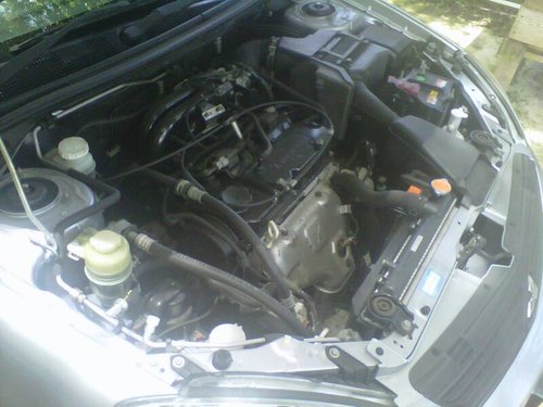

turbo_beast369 wrote:icefox
Let a mechanic (if you can't handle the job) take off the rocker cover and clean whatever you can see, I don't see another proper method of removing that from the head. Do it asap so the oil ports won't clog up.
Is it a simple job to take off d rocker cover an clean it for my self
Re: The Official CS Lancer Thread!
Postby Ted_v2 » November 1st, 2014, 2:57 pm
Yep.

Ted_v2 wrote:Yep.
Its not that hard.
it's jus bolts to unscrew, but wat exactly do I use to clean it with an wud I need any new gasket or any seals wen replacing the rocker cover
Postby Ted_v2 » November 1st, 2014, 8:05 pm
Not sure about the seals.
It should be able to just reinstall after. If the seals are hard however it might leak.
A good wire pick should remove it easily but if it goes down it can cause more harm than good.
U have a 4g18 not so?
Postby cinco » November 1st, 2014, 8:15 pm
Once u remove the valve cover replace the gasket and plug seals. Everytime u remove the cover replace.
Also when tightening make sure u run them finger tight then follow a criss cross pattern from the center out.

Postby icefox » November 2nd, 2014, 9:01 pm
Ted_v2 wrote:Not sure about the seals.
Nah I have a 4g15
Postby turbo_beast369 » November 3rd, 2014, 8:59 am
the CS 4G15 non GDI and 4G18 rocker cover and plug seals are exactly the same
Postby icefox » November 3rd, 2014, 1:40 pm
turbo_beast369 wrote:the CS 4G15 non GDI and 4G18 rocker cover and plug seals are exactly the same
Ok an Where is d best place to buy dese seals on d the east west corridor
Postby nissan4life » November 3rd, 2014, 2:09 pm
icefox you have the 4g15 gdi correct? if so this application wont work.
4g15 gdi in CS and the 4g15 CK engine (which i assume turbo beast is referring to) are two completely different engines.
BrotherHood
Posts: 8250
Postby BrotherHood » November 3rd, 2014, 2:15 pm
Mathuras Auto Parts in St. James has the entire rocker cover seal kit for about $150 max.
It includes the four spark plug seals and the rocker cover/tappet cover gasket. This plug seal kit can be used on the 4g13, 4G15 and 4G18 engines.
The 4G15 engine in the "new RORO CS3 shaped CS2 Lancer" is a DOHC non GDI n4l. The only difference in seals here would be the camshaft seals. Two on the DOHC and one on the SOHC. This same Lancer is what icefox has.

kjaglal76v2
Posts: 2214
Postby kjaglal76v2 » November 3rd, 2014, 3:25 pm
Brotherhood u dead wrong
the engine is a 4g15 sohc
BrotherHood
Posts: 8250
Postby BrotherHood » November 3rd, 2014, 4:22 pm
Yea yea, sorry bout da mixup. A non GDI SOHC 4G15.
Postby icefox » November 4th, 2014, 11:06 am
kjaglal76v2 wrote:Brotherhood u dead wrong
Yea dats my engine dere, 4g15 sohc
Postby Biggs3ne » November 5th, 2014, 6:16 am
it resembles d 4g18 real bad though...minus dat black cover

Postby BrotherHood » November 5th, 2014, 3:02 pm
The last batch of local 'long bumper" CS3's from Diamond Motors had that black tappet cover, just like in the pic. 4G18 engines.
Postby thatguy3832 » November 5th, 2014, 3:34 pm
The difference in them is the intake manifold.
