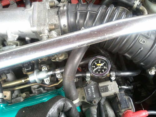

Ok peeps need some help again seems this car destined to send me grey. So I sort out the tranny probs installed a foreign used one got the car working then.yest it cut.off with.me. heard what sounded like a back fire saw the neutral light blinking but car was pulling.normal then stopped and car cut.off. restarted and tried to drive again but it only backfired as if starving.for.gas. changed fuel pump today bought foreign used one.with complete assembly still nothing. Changed fuel rail still.nothing. any ideas what can be the problem? Or suggestions?
Re: The Official CS Lancer Thread!
Postby Ted_v2 » October 9th, 2014, 6:28 pm
Access to a scan tool?
Install one of these if you think is fuel problem.
Under 200 by hyper v.
Postby gastly369 » October 9th, 2014, 6:31 pm
Getting.it scanned tmr Orkk will do but.it seems to be gas problem cause.it was starting and idling but as soon as u accel it cuts off. Now it stopped starting jus tumbling.
Postby Ted_v2 » October 9th, 2014, 7:10 pm
If you want a external pump. I have one. Could splice it in and boost the gas coming from the tank. Could be that.
What about the fuel filter .does it have one in front?

Postby gastly369 » October 9th, 2014, 8:25 pm
Ok will let.u kno tmr wen.I go by.the garage.but.they were telling.me that wen they used gas externally.it.was working but wen connected back to the line from tank it not. So.I'm wondering.I'f the gas line has a clog. Going.tmr to see Wats going.on so will have better update.
Postby Ted_v2 » October 9th, 2014, 8:44 pm
See if they placed back the correct line in the correct place. Simple mistake

gastly i would scan the car instead of wasting money guessing. How the intank pump is amde up there is no way you could screw up the lines as they are cut exact for the opening on the pump assembly. Buying a used pump doesnt mean it is pushing the required psi, also these pumps normally sit for a while so wateva dried in the pump could of been pushed down you fuel lines if it wasnt cleaned before assembling. You mite also want to check you intank fuel filter to make sure its clean.
